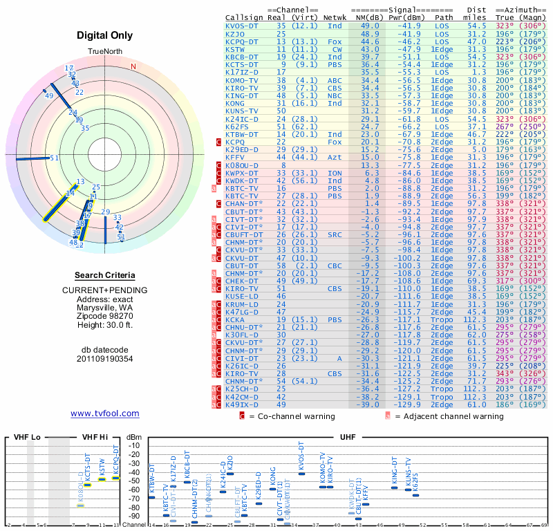

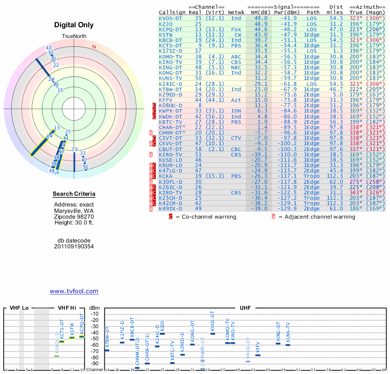

Also, I dont see CBUT (43) in your report. Are you sure you set the options on the report page to "PENDING - DIGITAL ONLY?" That will give you the most accurate numbers here.
Including pending...
http://www.tvfool.com/modeling/tmp/6...r-Digital2.png

Oh, I've got that DTV box too, CRA-TR-40... heh... I like it since it's got the "manually edit channel" feature that many boxes don't.... and supposedly it has a good/sensitive tuner.
Anyways, I think if you do the PENDING DIGITAL option, you should see better NM values and where you're at.. if you want those BC stations, getting a 91XG antenna should give you a very good chance to pick them up...
.. that's what I plan to do, and my NM is much worse than yours...
post #9214 of 9744
Ah.. much better.. yeah, those BC stations in light red (pink?) you definitely should be able to pick up with 91XG antenna and your pre-amp.
That's RF channels 22, 43, 32, 17, 26, and probably 20 too.
That's good programming/shows from our neighbours up north! (heh).

Was there tropo conditions this morning?
With KT-200 preamp and same VU-190 antenna with aluminum foil on the lower reflector, this morning, I was able to get picture on CHAN (RF 22), RF 20, 26, and 43.
CHAN was the best with SNR of about 18. RF 20 was weakest at SNR 16 and breaking up here and there.
Probably when I get home this evening, they'll probably be gone.
If you're in Marysville, you should be able to get it now under tropo.
post #9237 of 9744
Wizeguy6,
From your Tvfool report, normally you should be able to get most/all of the Seattle stations no problem with an outdoor antenna.
But if you've got tall trees blocking your path a hundred feet away or so, then yeah, that'll really block the signal.
At worse, you could try to play with height and position of the antenna (just walk around on your roof and carry a portable DTV and hopefully with a signal meter).. it's a pain-in-the-butt time consuming process, but if you have the time, I'd go for it.

I'm trying to see which house is yours from the Google Earth shot.
North up 48th, on the west side of the road, the third house from 220th appears to have a brown roof, with an outbuilding that has a red roof. The 4th house up is about 100ft further north, light colored roof and sits at a 45 degree angle to the road. On the east side of 48th, about 150ft north of 220th, is an L shaped house with a big driveway and parking area. Where are you in relation to these houses?
KIRO translator from MT Vernon should be line of sight, almost due north. It doesn't have much power, but it's only 20 miles. Lowering your antenna should still receive it with all that equipment you're using. The nearest hill is across the valley, 3 miles away, not a big problem.
Also, when you had everything working okay, did you ever swing the antenna around to the south east and try for Tiger MT, by Issaquah, for ch51 KIRO? It's very high and should be line of sight as well. A lot farther, but could work, too.
As for KVOS and Vancouver, I would like to see which house is yours to get a better idea of what you're fighting.
I would bet we could get you back down to a reasonable height of 10ft to 20ft at the original location.
As for a good tuner, I found the ChannelMaster to be very sensitive and selective. I carry one in my van for testing. Works at very low levels of signal, below the minimum of what my meter reads, at -25db. Most TV's won't work below -15db. They carry two flavors at Fry's. One regular HD model
