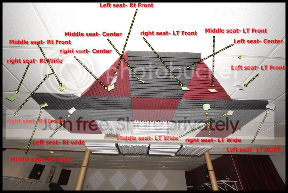

figured I would post some pics of some traetments I have redone.
Here is the foam I had with all reflection points "Left side MLP"
GIK suggested 3 panels on this side and the farthest panel is not touching the "tri-trap" although it looks like it LOL!!
Here is the foam I had with all reflection points "right side MLP"
GIK suggested 3 panels on this side also.
Here is the Tr-trap in the corner, I have 2 tops coming also that will stack on these full size ones and will extend it to the top.
Here is the foam I have on the ceiling with reflection points (all 3 seats) and I have 6 242 panels on the way to put in place of the foam.
So far the bass has improved dramitaclly and the detail has also increased dramitacly over the foam.

Wow, just ... wow.
Would you mind commenting on what the panels left/right wall are made of (material, depth etc.)?
I'll bet you'll get some additional improvement when you fill in your corner traps as well.
I think the let side of MLP as 1 to many panels but it is just to make sure.
Here they are:
http://gikacoustics.com/gik_242.html

Originally Posted by pepar View Post
Wow, just ... wow.
There was a lot of curse words used in getting those reflection points...never realized how many there where...I was only doing 1 seat before LOL!!
