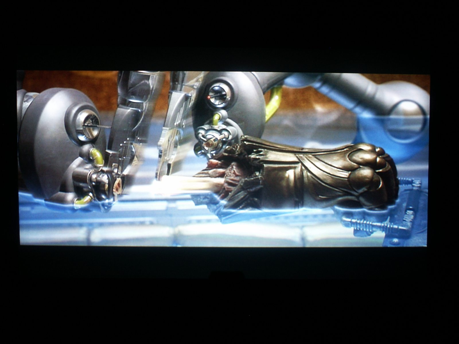

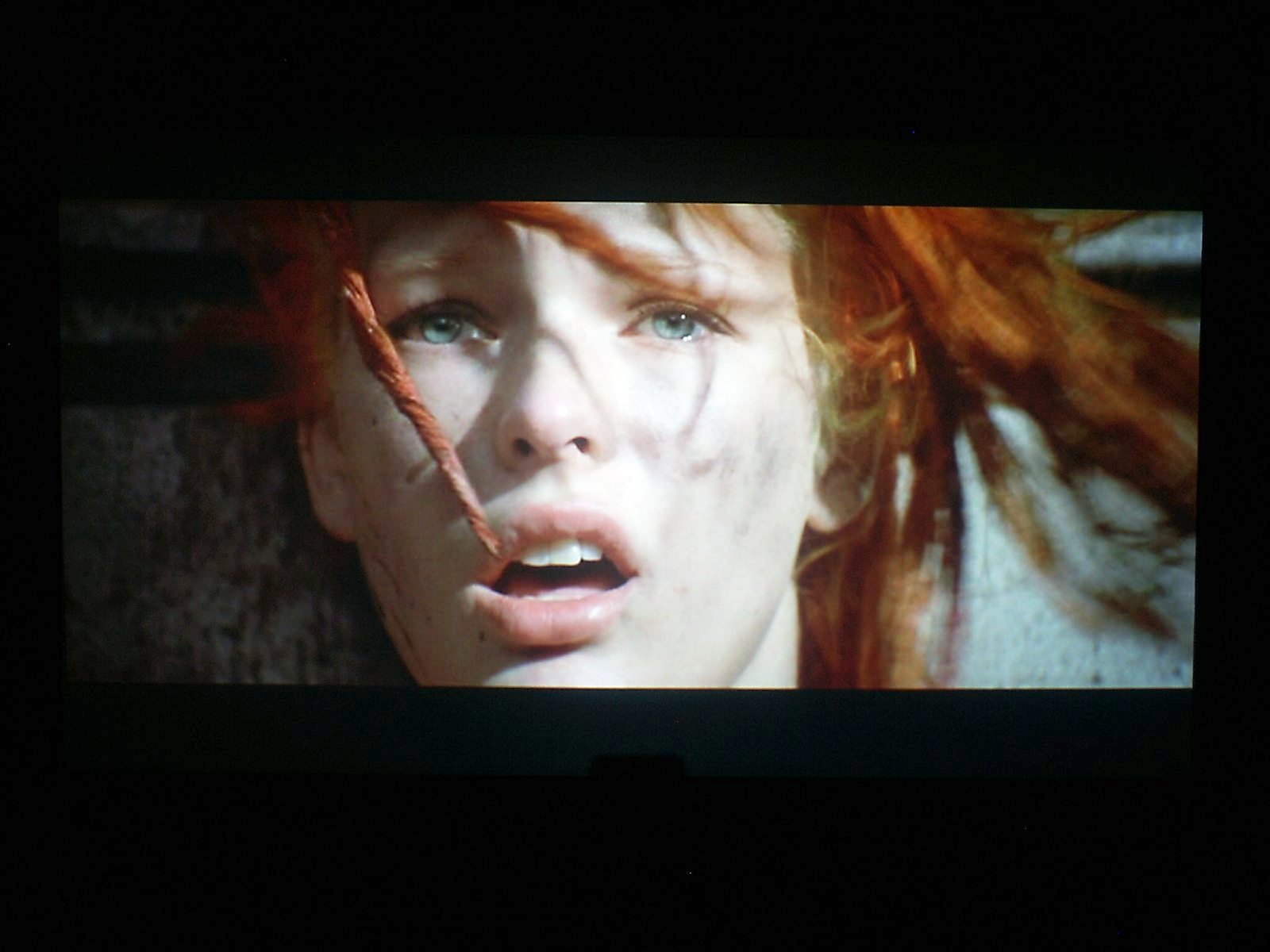

I had the privilege today of helping Jeff “thebland†set up his new HDL and JVC DLA-G150CL with Panamorph.
We connected the HDL DVI out to the JVC DVI input. The DVD player was set to 480i output via SDI to the HDL SDI input. The output aspect ratio was set for 1.33:1 at 1280 x 960, 60Hz (1.33 was used to accommodate the Panamorph). The projector was set to 1:1 pixel mapping and zoomed slightly to fit the screen.
After everything was connected and set up we fired up “The Fifth Element†Superbit edition, to try things out. After some adjusting with the Panamorph, the picture snapped in and looked great, see the attached screenshots. After a minute or so, we noticed that the projector was “loosing†the DVI signal and would drop to the “blue†no signal screen for a second and then “find†the signal again. We checked the connections. The SDI connection to the DVD player seemed loose, so we tightened it up. Still drops to a blue screen every few seconds at seemingly random intervals. We tried a different SDI cable, same result. Next we tried displaying a KDL internal test pattern, with the same loss of DVI signal.
Thinking the problem could be in the DVI cable, we replaced it. No signal loss for a minute or two, then it began again in earnest, end of DVI fault theory.
In a long shot hope of stopping the “blue screen†menace, we changed the output refresh from 60Hz to 72Hz. Lo, and behold the signal loss stopped, but was replaced by horrible stuttering as the projector translated the 72Hz frame rate to its internal 60Hz panel refresh rate. We also tried 48Hz and 75Hz, neither of which produced the “blue screen†effect. 75Hz refresh minimized the stuttering effect, but does not eliminate it.
We tried using the component input on the projector at 60Hz, and the RGBHV driven by an HTPC/Laptop, all of which worked fine.
Ran out of time and didn't get to try it with an HD source.
At this point I’m not sure if this is an HDL issue, a JVC issue or an interaction of the two. The picture quality produced by the HDL was much better than the internal JVC de-interlacer/scaler. Overall the HDL was not difficult to install or set up, although the response time on the menu, in particular on the output resolution setting, is slow.
Screenshots:
http://www.cmcpics.homestead.com/screenshot1_thumb.jpg
Click for full size image.
http://www.cmcpics.homestead.com/screenshot2_thumb.jpg

"In a long shot hope of stopping the “blue screen†menace, we changed the output refresh from 60Hz to 72Hz."
My G150 handles DVI (1360x1024 and 1280x1024) @ 60Hz without any issues via HTPC using the ATI 9000 Pro. I thought they were going to ship the 1360(5) resolution for the G150 as it seems a shame to go to these lengths to get a great image and then have to zoom it.
post #70 of 1632
Is it just me who is impressed with the color fidelity of those screen shots? The images are a bit soft, it's true, but I assume that's the result of pausing the DVD player. But the quality of the color reproduction leaves nothing to be desired.

I think that the proper way to isolate myhspt/thebland's problems is to determine the exact timings (front porch/back porch/etc.) used by the HD Leeza, and reproduce them with an HTPC running PowerStrip, using the same DVI cable. If the blue screens persist, then you can eliminate the HDL as the problem...
I had a blue screen problem with my setup awhile back, and the culprit ended up being the video card's DVI output. The giveaway was that my HDTV decoder's DVI output never caused blue screens.
post #72 of 1632
mysphyt,
Those pictures look very nice, were they taken when the player was paused or while it was running?
You need to find a spot where motion is almost non-existant and shoot while the player is running (pause usually reduces the resolution dramatically!).

I switched from 1080p to 960p for NTSC DVD and all the artefact problems I saw with the Fifth Element went away! This must indicate that the scaling algorithm in the HDL is to blame, and then when scaling from SD to 1080p it introduces the errors we are seeing? It also explains why HD deinterlacing to 1080p actually looks so good because the scaler isn't involved...
Mark.
You can not judge color by watching screenshots taken
by a camera. The camera has its own color reproduction
function. So does the monitor you watch the picture on.
On my monitor for example Leeloo's hair is way too brownish instead of a vivid orange.
post #76 of 1632
mhafener,
You need to calibrate your monitor to avoid such problems.
Only very high end digital cameras allow you to produce a perfectly calibrated image from their output.
That said, mysphyt's pictures are very vivid and good looking.

The screen shots looked great in person (more vivid) and darn it!!! I should have engaged the Electrimask.
Charles, if I remember, wasn't there a mod of some sort to get the G-150 to accept DVI at 1360 X 1024 (1:1)???
Would LEEZA be capable of deleivering 1:1 1360 X 1024 via a firmware upgrade? I remember getting that resolution was somewhat complicated.
Could you explain?
A 1360 X 1024 resolution upgrade would be pretty desireable for us DILA (G-150) users.
Mike ....are you listening;-)

You can calibrate the whole chain, but that's impossible
in this context, if someone posts a picture taken with
an unknown camera and unknown settings from an unknown
screen and so on. First you need a reference that's correct
and then you can tweak the whole system till the monitor
looks like the reference.
Posting pics here proves nothing, neither good nor bad.
It can be fun to watch, but further conclusions are invalid.

The screenshots were taken in pause mode. The actuall dynamic range on the screen is higher, the whites are a bit crushed by the camera in the photos. The color fidelity really is that good. We did a complete calibration on the projector before setting up the HDL. All this on a 10' screen too!

I think we are all aware of this having hung out here at AVS for years now. But we're not printing a 6-color catalog here -- we're just trying to get a sense of what the HD Leeza is like. By comparison, having seen precisely the same scene on a G90 on Friday, fed by a Faroudja DCS at 1365 X 1024, my general sense from those photos is that the projected image through the HD Leeza and JVC is pretty darn good.
That's all.
