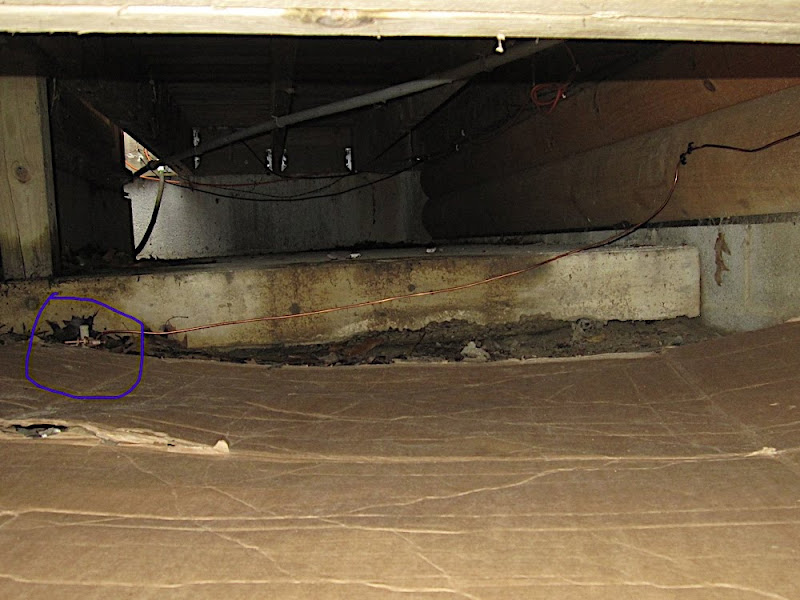

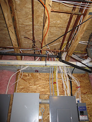

I had same problem, the cable people did a crappy job with grounding using cheap clamp, it had I think a bi-metallic corrosion going also as well. (wiggly clamp)
Before showing cable install job:
I took the clamp off, went to HD, bought 6' copper wire, attached to inside home copper pipe, actually next to where the 200A main also had a ground wire attached.
Copper wire going into basement shown:

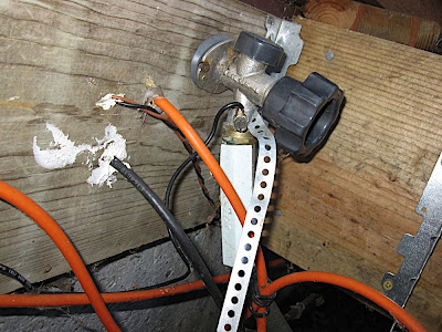

To make matters a little more complicated, my outside faucets are "isolated" and not really connected to my inside pipes, due to my whole home EcoSmarte system, which uses various plastic/assy stuf for flowmeters, electrodes, etc.
So I connected a jumper wire from my inside pipes to my outside pipes, just to have them on the same ground plane.
