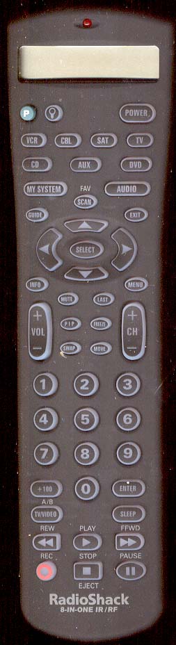

What is the command to put a pause in middle of a macro without JP1, or is there not a command?
Also, do you know if this remote will retain its memory if the batteries die?
Im reading the modified features of this control http://www.avsmarts.com/product_info...oducts_id=5949
and wondering if the 15-2117 has these features.
-2k EEPROM chip and have added the 6-pin header.
-Better range - we've pulled the IR-LED out further to improve the remote's performance
-Permanent Memory - with an EEPROM onboard, this remote will retain it's programming indefinitely, even when the batteries are out.
-The remote now includes the HOME/0167 X10 Home Automation code that's missing from the un-modified remote.

There is no command for pause. You need to use JP1 and extender which
has a special protocol for pause. Trust me, just buy or build the JP1
cable, you will be happy with the results.
The 15-2117 has the 6-pin JP1 header builtin, no need to add it.
The 15-2117 retains memory when I swap out batteries. I never left
them out for really long periods of time, but I assume the memory will
be retained and if not, it takes literally 10 seconds to load up the backed
up memory (that includes plugging in the cable, running the app, loading
the backup file, and uploading to remote)
15-2117 has 2 IR transmitters which means it regularly performs better
than many one-for-all remotes which mostly have 1 IR transmitter. OFA
makes the remote for Radio Shack but I guess RS just spec'd it better.
Once you have JP1 cable all the device upgrades are available so it
really doesn't matter whether HOME/0167 is included or not as it is
trivial to add.
I think the cheap price you paid for this remote has you confused. This
is one of the best JP1 remotes you can buy. Some people will have
preference for different layout or more dedicated macro buttons, but
personally I like the 15-2117 layout better because it is very clean and
easy to find all the buttons. Also with Long Key Press, I don't find the
need to have dedicated macro buttons, as all the buttons can serve
multiple functions depending on whether it is short or long key press.
Also there is a shift-button which further lets you overload the buttons.
I prefer the rocker-style vol+/- ahd ch+/- over the 2 offset button style.

Thanks for all the info. You convinced me buy a cable :)
I setup some macros on the remote already, but i can see that it will be a PITA without have a long key press (ive already accidentlally pressed the key I assigned to the macro).
Now I need to find a good place to buy a cable :)
I havent soldered a circuit board since college (6 yrs). :)

For some reason, the backlight on my remote wont work. Anyone else have this problem?
I press it, hold it, I cant get the light to come on :(
It was working the since Sunday when I bought it. It was the last remote my local store had...
post #305 of 394
I'm currently using 3 of these remotes and the backlights all work.
You don't press and hold to turn the light on, you just press once and
from that point on whenever you press a button the backlight comes on.
Press the light button again, and backlight will not be turned on when
you press any button.

I dont understand what the problem is. I posted this last night, and it wasnt working. When I got up this morning, I tried it out, it worked fine. When I got home from lunch, it worked for a second, then went off. WTF? I just bought this remote on Sunday, and it has fresh batteries in it.
Any ideas? Can I easily disassemble the remote to see if something is loose?
Another idea I had was to buy the 15-2116, and swap remotes out since they dont have anymore 15-2117s. The 2116 looks like the 2117, is it exactly the same?

For some reason, the backlight on my remote wont work. Anyone else have this problem? I press it, hold it, I cant get the light to come on
I suspect that you don't know how the backlight works, and I don't recall how well it's described in the manual.
If the backlight feature is currently off, pressing the light button with BOTH turn the light on and turn the backlight feature on. When the light goes out, which it will after a few seconds, pressing any key will turn it on again. If you press the light button now, you will be turning the backlight feature off, therefore if you press any regular buttons at this point the light won't come on. If you press the light button again, you will be back to square one with the light feature on again.

Well, I exchanged my remote at another Radio Shack. This one seems to be working fine. Hopefully that was a bad remote, and it wont happen on this one.
I still need to get a cable, trying to decide if I want to build one, or buy it built. Could be a fun project, and I was thinking of getting a "Cold Heat" solder gun.

YOUR remote *DEFINITELY* has more interesting "BUTTONS TO PUSH" than the:
http://www.replacementremotes.com/st...s/150-2117.jpg
Where can I buy *YOUR* remote? :D
