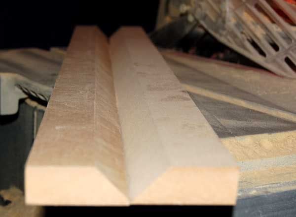

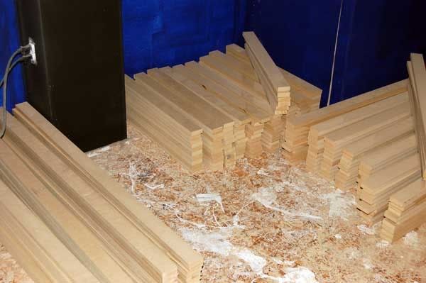

Okay, I have a nice big pile of ripped down mdf (3/4")
and ply (1/4"):
Next step is cutting the mdf to add the bevel. I know Greg went with the router. I am a dead man if I buy another tool, so it will be the table saw for me. I need to work on my skills.
At this point, since Lowes only had 3/4" mdf, I went with 1/4" ply for my 1"frames (all but the back wall), I am thinking I will glue the mdf and ply before assembling my frames. I was planning on miter cuts, glued, with brads. I hadn't decided whether to make the miter cuts separately for the ply and MDF, or after they are glued. I was thinking about making the miter cuts first, then gluing the strips together, then joining the corners to make the frame. With this approach I might be making a frame a night. Slow yes, but doable.
Any comments? I am open to suggestions.

When I started my beveled edges, I tried the router... what a mess! I changed to doing all my beveled cuts with the table saw. I didn't do the miter cuts, but opted to just bevel the top layer (ie, the MDF) along the length of the side and top/bottom for the corners. I glued all the pieces together, then I used a brad nailer for extra strength. Actually, once I got my assembly line set up it was cruising right along... but it did take some time to do the whole room.

post #439 of 897
Yes, I cut them to size first then I gave the MDF the bevel cuts. I have to admit that the GOM does hide some of the minor mistakes...
