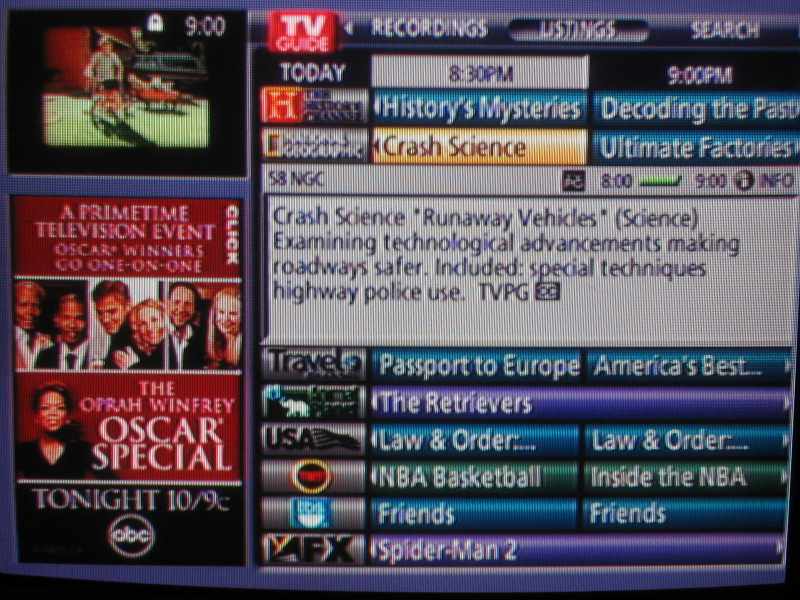

Tonite, I noticed for the first time that Ads have filled the Ads area in the TV Guide. They are static ads but do rotate between 3 of them when you scroll through the TV guide listings. If you move the cursor over to it, the listings area displays more information that pertains to the Ad. My box is hooked up to analog basic cable provided by Time Warner in Fullerton, Southern California.

post #8719 of 28625
I'm also getting them OTA, so the ads have come to Southern California.
