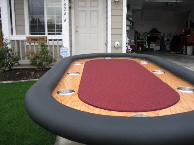

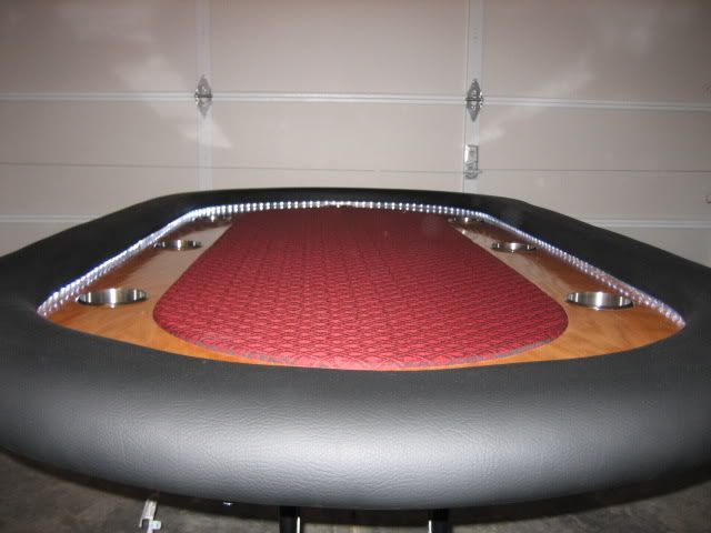

Well, a little update here!!!
I finished with a table for detn8r, (my photography skills SUCK!!!)
I must say that it was great dealing with you detn8r!!! I hope you are happy with how it turned out!!!
Now, you had better shoot some photos when you get the room all set up!!!
Thanks again!!!
David

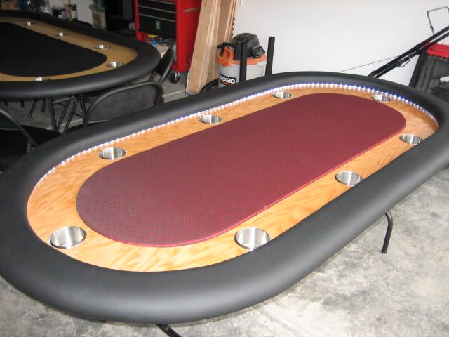

Here is another table (#4) I just finished up on...
Let me know what you guys think!

post #85 of 137
David-
Nice Table, what type and color of stain is that - I like!!!
post #86 of 137
Originally Posted by dlkemp22 View Post
David-
Thanks man!!!
The stain is Minwax "Ebony".
David

post #89 of 137
Davidr2340-
How many coates of the stain and poly did it take to get that color and what do you use to apply it? I am building a table now for a customer and they want the ebony color stain with orange playing surface (UT FAN). One other thing, did you just follow the instructions off of the can for staining or do you your own method (like drying time). I just really like the finished color of your table, and I am trying to get that same finish.
David
Well,
That is two coats of stain and about 10 coats of wipe-on poly! I apply the stain with a rag (sock, old shirt...), give it about to days, then apply another.
I'm pretty new to staining, but so far I've been happy how stuff has turned out!
Let me know if you have any more questions!
David
