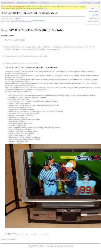

Ok, so who's tv is this? I bet it's someone watching this thread.
