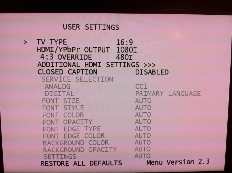

post #6163 of 6230
Originally Posted by Holmquist View Post
I have the dct3412 and am wondering if I can get it to just display the current time instead of the channel number.
With the cable box powered on, press the Menu button.
This brings up the "Quick Menu" at the bottom of the screen. Choose the following: Menu > Setup > Cable Box Setup
The first option is called "Front LED Display". Change it from "Current Channel" to "Current Time"
Also powering it down and hitting the menu button to enter the system menu it frankly just doesn't seem to work worth a ****. It displays the format (16.9) but I can't change any of the other settings. And shouldn't some sort of GUI show up on the television? Because currently it doesn't.
There should be a "User Settings" white screen displayed on the television.
Here's what it looks like:
If you're not seeing that, then there's a problem.
post #6164 of 6230
Excellent thank you fellas. I eventually got the on screen display to show up. And the display now shows the time. One more question what does the MSGS. red light mean? Thanks
