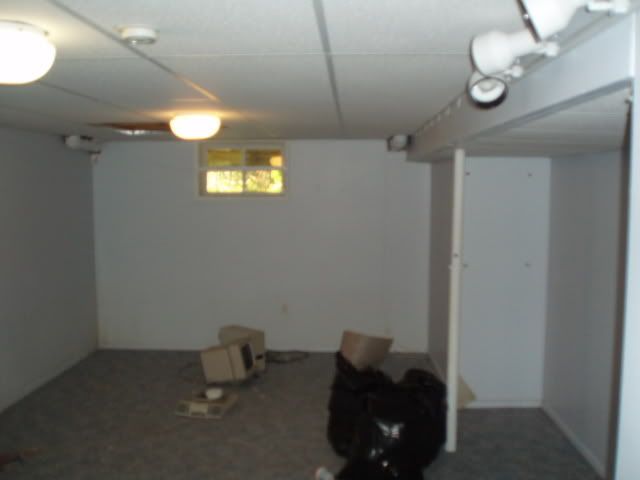

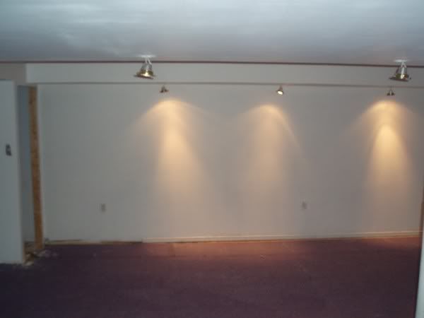

I posted this in its own thread , but thought i would share my basement in this thread as well

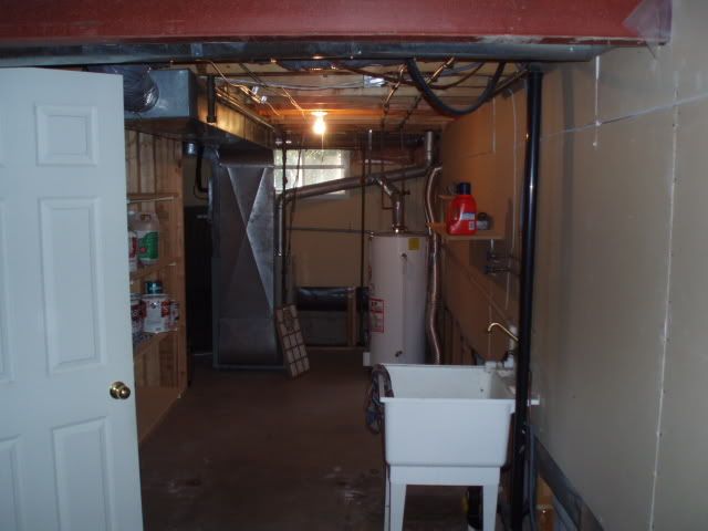

the old owners thought they new what they were doing when they finished the basement but it was horrible, dark damn they basement was split down the middle 1 half being the rec room the other half the furnace room laundry room and rough in for bathroom

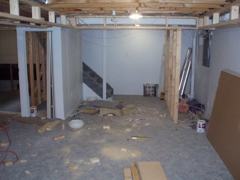

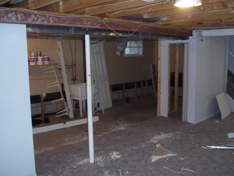

I ripped down the drop ceiling and the wall dividing the basement

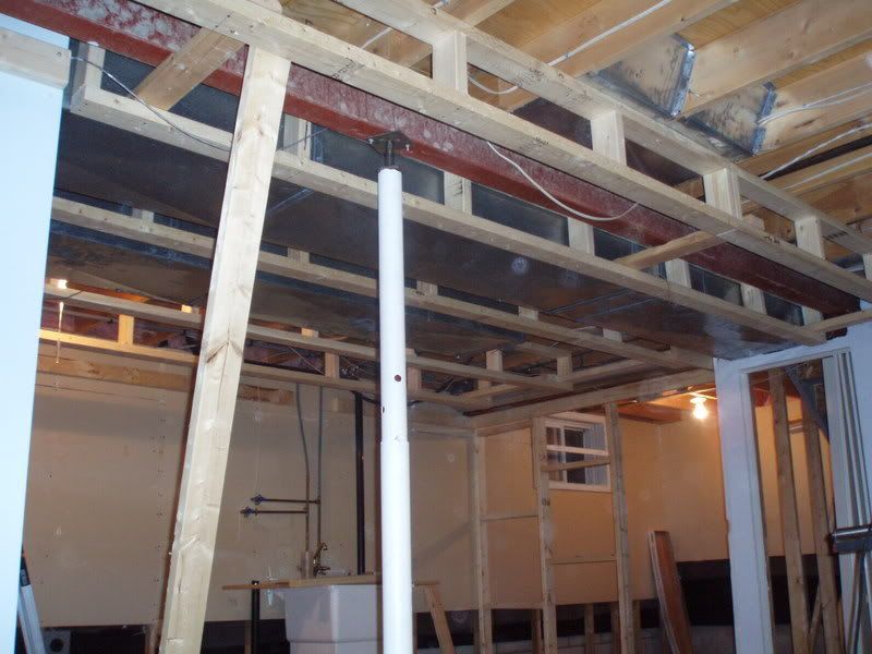

having the ductwork and plumbing all exposed on the storage side of the basment I had to drop the ceiling below the ductwork , so I built drop peice that would allow me to maintain the most head room below the ductwork
I relocated the laundry room into the rough in for the bathroom, we already have 2 and don't see a point to have one in the basement
the corner where the sewage pipe and electrical was I built a small storage room to isolate that ugly corner of the basement
I also defined the room while also allowing me to hide some vents that could not be relocated, and I wanted to hide the bulk heads
this allowed me to put pot lights in as well for a nice touch

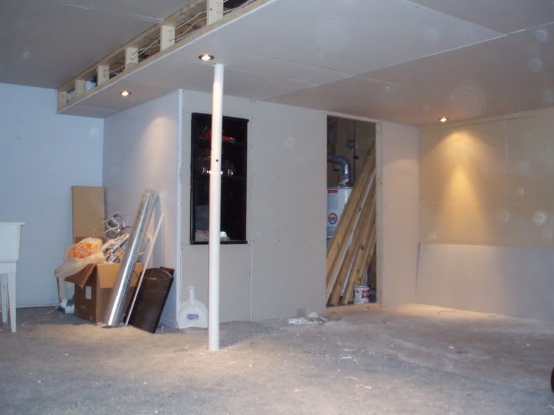

Well its time for drywall and lighting
the corner where the furnace was there was enough room behind the furnace to use as a component closet
Installed the Pot lights and primer on the walls
