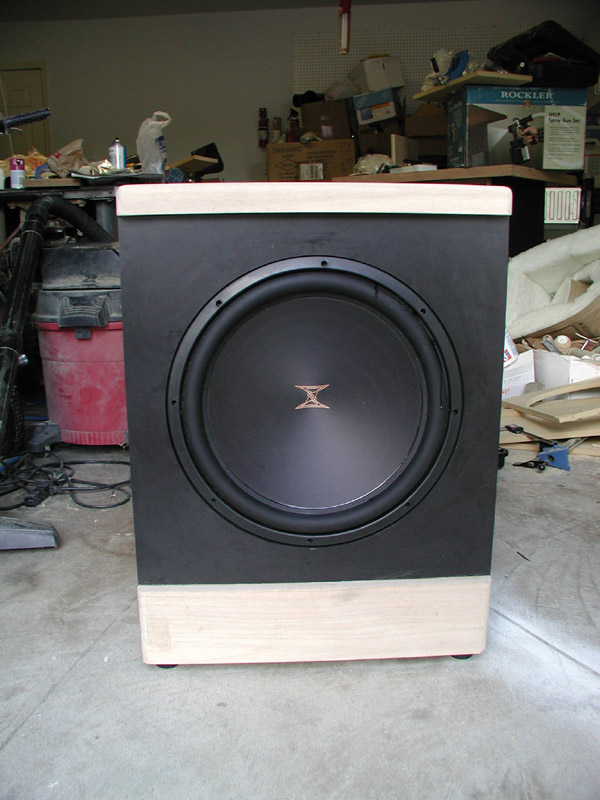

I'm still only half way through my sub build-up, but I thought I'd go ahead and post a couple of pics. Keep in mind that these pics of the enclosure were taken right after I installed the driver for the first time. The box is unsanded and not cleaned up. I hope to put a finish on it within the next couple of weeks.
Design: Sealed
Enclosure: 20" wide x 26" high x 22" deep
Driver: Sound Splinter RL-P15 4ohm
Amp: Nady XA-1100 (2x475w @ 4 ohm)
EQ: Behringer 1124P (BFD) - Not used yet.
Total Cost: Haven't added it up yet.
Prior speaker/sub construction experance level( 1- 10):
0
Construction Thread with Photos
Summary:
Even in the Houston heat of the garage, I had a blast working on this. I took time off from working on the house just long enough to throw this together and plug it in. Now lets see if I have time to tweak it.
