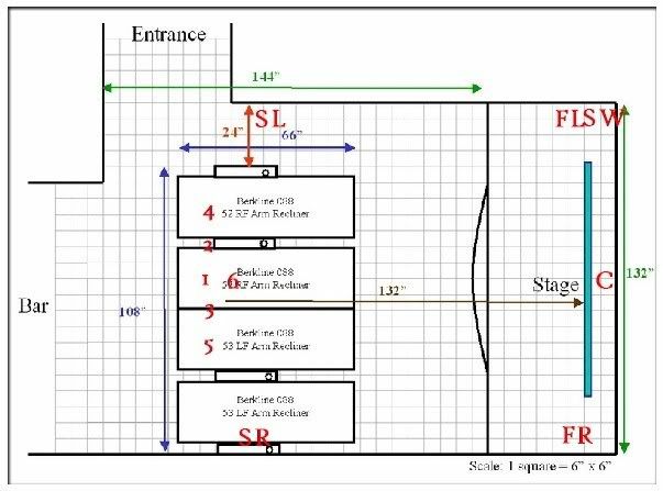

Thought I'd post the Audyssey results from tonight
FL----Large----10' 6" -1.0db
FR----Large----10' 8" 0.0db
C-----Large----10' 8" -5.0db
SW------------11' 6" +0.5db
SL----Small----6' -2.0db
SR----Small----5' 6" +7.5db
I made total of 6 measurements which were all mirrored on center of room (see below) so don't know why some of measurements are out of whack......the center really worries me as I always find with Audyssey its too weak. And as I mentioned if I tweak a setting Audyssey does not come on. I don't see this issue if I manually calibrate with an SPL meter.
Going to check all speaker terminations tomorrow and re-run Audyssey. If its still out of whack will revert to manual calibration and get on with the subwoofer calibration.
Cheers,
Mark

Here is my problem, my sub can only fit tightly in the corner with either port facing forward or backward.....lets call it poor planning.
I decided to take afternoon off to play while no kids about.
Plan of action.
1) Check all speaker connections
2) Calibrate with Audyssey (write down settings)
3) Calibrate with DVE (compare settings)
4) Rerun the REW measurements
5) Configure BFD
