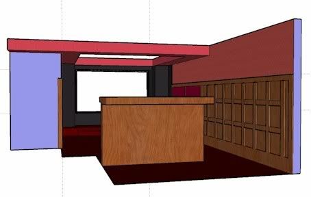

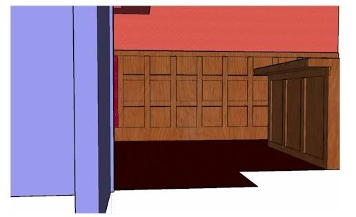

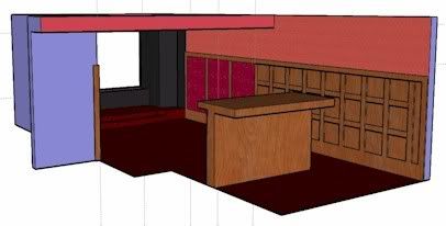

Here a a few Sketchup Renderings of the basic look I'm going for.

I love it! I plan to do a bar in the back of my theater too. I think it lends better to larger groups especially during sporting events.
post #249 of 1328
Panels like that will be cool looking!
post #250 of 1328
Yeah, I like the panels, similar to what I want to do for my bar.
Drew
post #251 of 1328
Thanks Guys, at moment the acoustic panels are shown as 2 - 3' wide but I think I'll go with 3 - 2' panels.

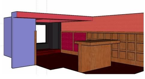

Here is view showing 3 panels in the HT area......I think this looks better that the 2 panels (in post #247)

Thanks Guys, at moment the acoustic panels are shown as 2 - 3' wide but I think I'll go with 3 - 2" panels.
For ceiling/Soffits going for a Red (like Behr Ruby Ring - S-G-150)......need to decide on panel fabric and whether to paint or wallpaper above the panelling.
And got my bonus thru today so going to be on a spending spree today
Congrats!!
We went red for the soffits too Behr Chianti... just finshed the last of the painting last night!
Oh, and HD has BEHR paint w/ a $6 rebate going right now.
(And Lowes has carpet/flooring at 20% off).
Man those 2-inch panels are gonna be skiiiiny!
