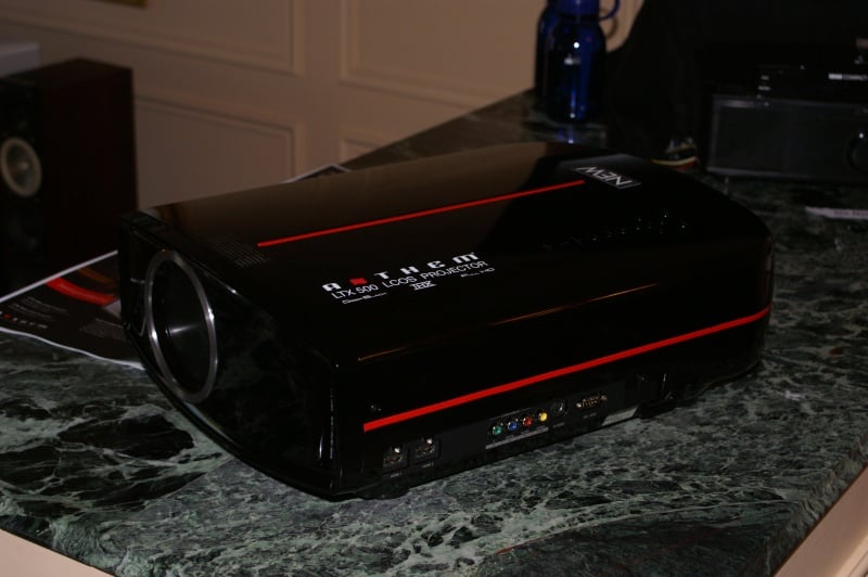

Originally Posted by gblack View Post
Interesting article on Engadget about Anthem partnering with JVC to provide an HTIB which would presumably contain an AVM or statement pre pro and a JVC projector rebranded under Anthem's brand.
http://www.engadgethd.com/2009/01/13...igh-end-htibs/
I realize this is off topic, but now we have more info on the Anthem projector and an image:
http://www.audioholics.com/reviews/p...anthem-ltx-500
