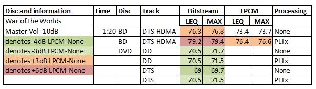

Interesting, heres what I found with War of the Worlds (AU release) DTS-HDMA 5.1
Thats the Morgan Freeman narration at the start of the movie so mostly Center channel dialog. Certainly showed PLIIx increase by 3dB
My processor is AVM 50v.
offcurse i have the DTS HD isse regards L/R fronts
I'm running the last official D2v firmware(v2.10), so maybe there's a difference. Should point out though that I'm not certain what fw version I was running when I ran the above test.
Cheers

Well it's got me quite baffled as I went through some quite extensive and vigorous testing which proved PLIIx caused an increase of 3dB on atleast LPCM 5.1 without a doubt. And it wasn't just me, others tested and had the same observations.
I'm pretty certain those tests were conducted on my current fw 2.10. So it has me perplexed.
I'm not looking forward to it but it looks like I will have to get the test gear out and spend a day running some thorough tests again.
Edit: Here's one of the old tests
Cheers
