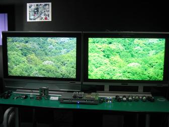

LCD TV comparison: Proton 42-inch CCFL-based LCD TV (left),
42-inch LED BLU (5/6G version from NCU Solid-State Lighting Group)

A: We have successfully developed a 42-inch LCD TV prototype using our fifth/sixth-generation LED BLU. We spent one month from the design of the module, to the LED package to the complete prototype, with the overall expense at around NT$300,000 (about US$9,211). We have worked with Taiwan-based LED packaging houses such as ProLight, Ledtech Electronics and Advanced Optoelectronic Technology (AOT) for developing the prototype.
The model has a 558-nit brightness, compared to 400nits from traditional CCFL-based models, and the performance of red and green colors is significantly better than that from a CCFL-based one. We have filed related patents for the model, with those for the US also under preparation.
