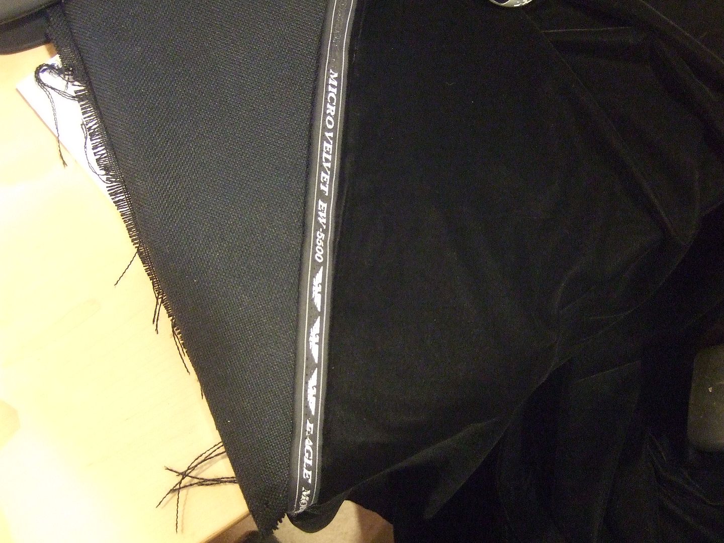

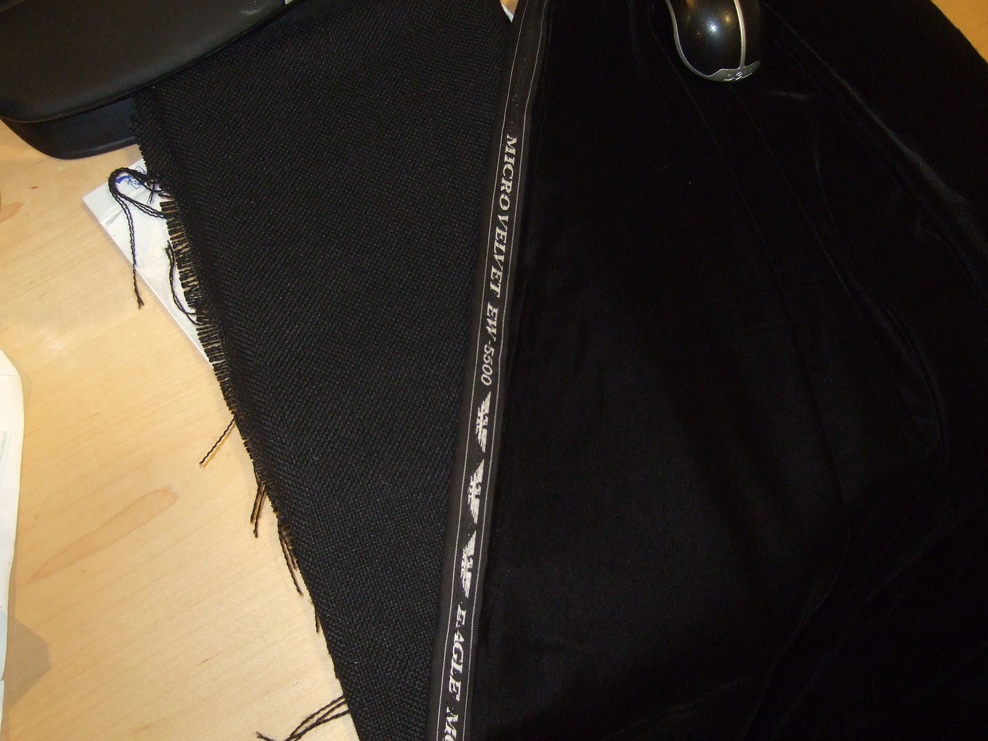

Here are two pictures comparing the Micro velvet to GOM FR701 (AKA the burlap)
First no flash:
With flash:

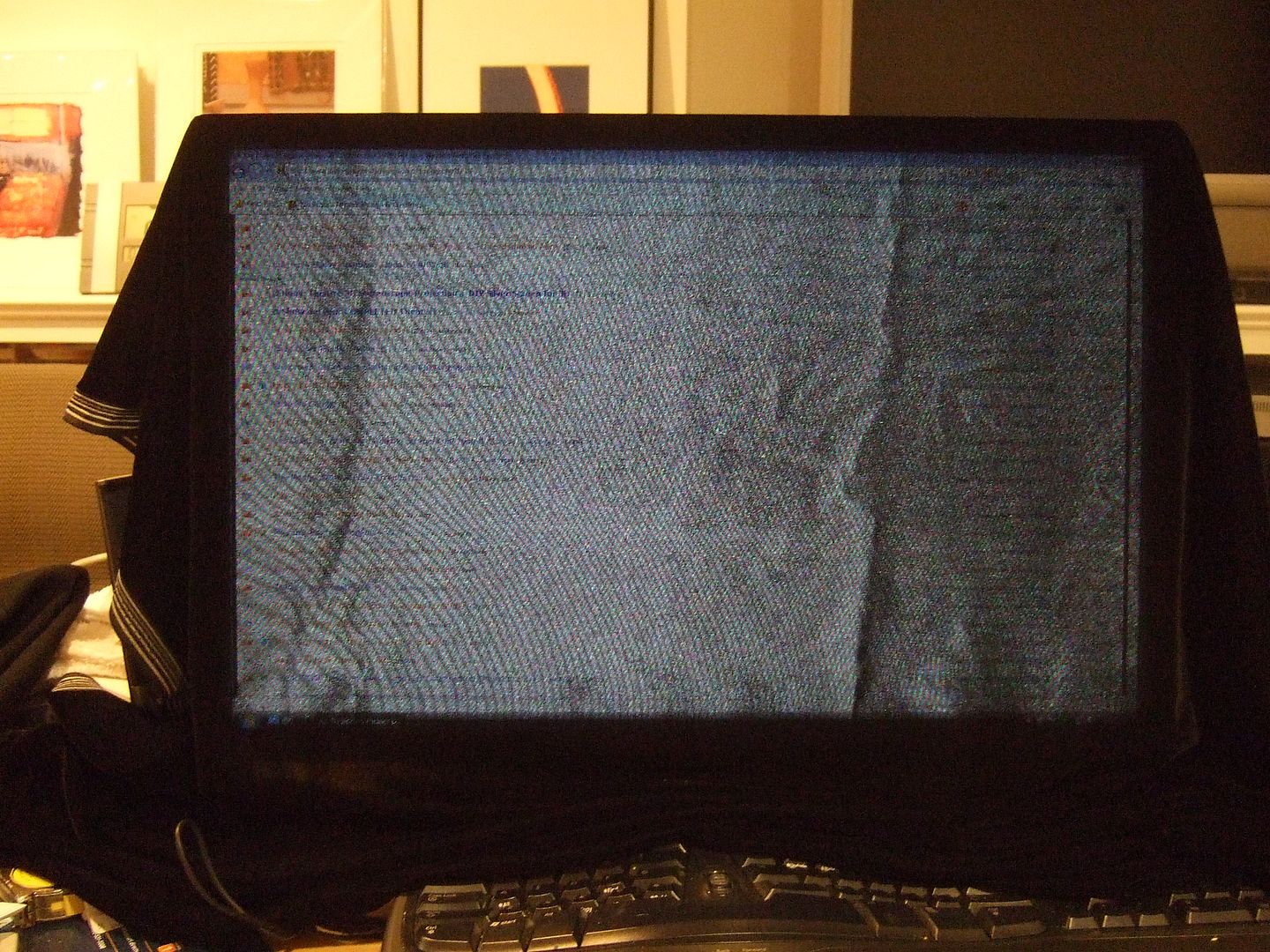

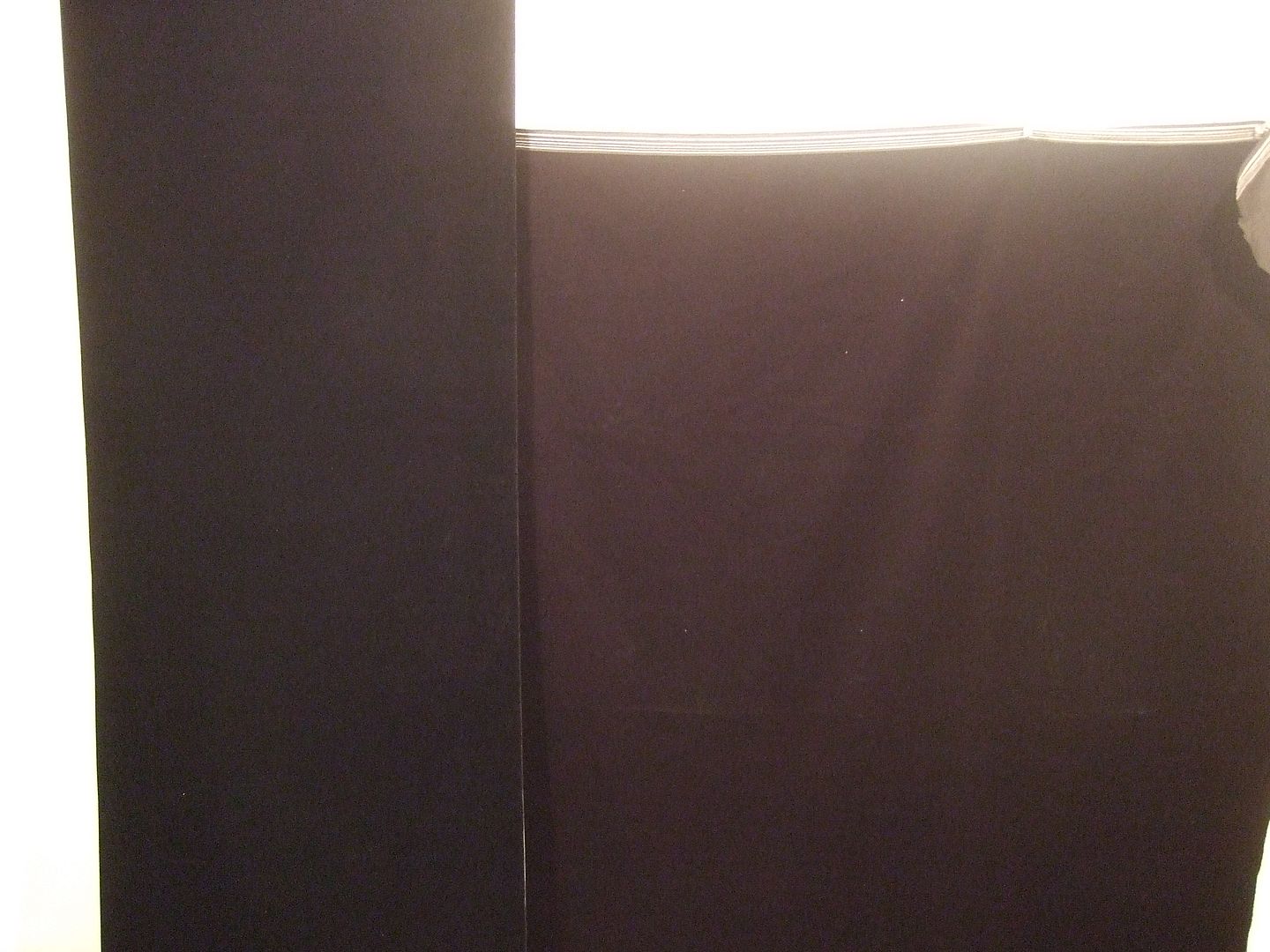

I don't have any test equipment to test for Acoustical transparency but I can do a blow through and shine through test. Here is the shine through results draping the fabric over my monitor:
GOM FR701:
Micro velvet:
I've been very happy using the Micro velvet. It is darker and a little "classier" than the burlap. It matches the screen frame and masking panels perfectly and makes the screen look almost like it is floating in mid air. With only the sub behind the fabric I can't detect any difference in the audio.

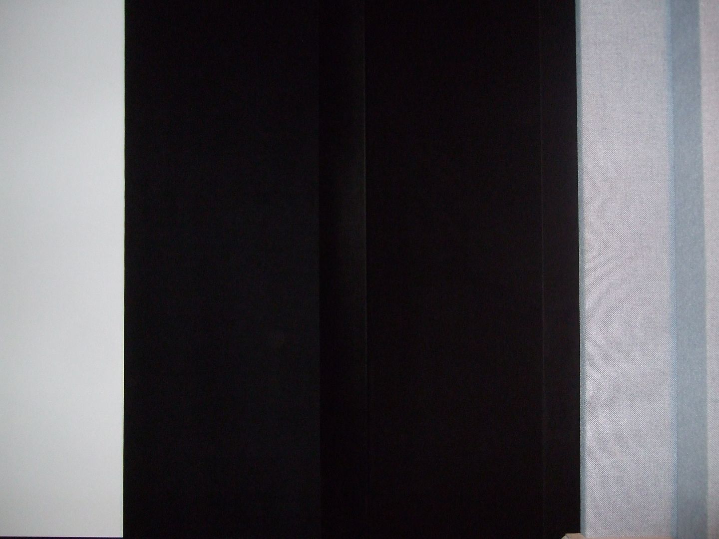

Comparison of SMX screen, Pro Panel, Frame, Micro Velvet, GOM Crystal blue. Left to right.
Notes: the micro velvet is at an angle to the camera. the Pro Panel is showing some reflection back from the screen. Under different lighting conditions the Pro panel actually looks darker than a swatch of the Micro velvet so I am now convinced that they are only nearly identical.
This picture really surprised me because I can not see a difference with the naked eye but when I look at the LCD viewfinder I see this difference:

Wonder why the difference through the view finder? Hmmmm......interesting for sure. What are the colored lines (red and blue) that I'm seeing in the photo of the micro velvet?
Which photo? If it is the one with the monitor that is different colored text on this forum.
post #1392 of 1585
yes, see update above. They are only "nearly" identical
The color difference could be just the flash and the reflected light that it produces?
post #1393 of 1585
Good thought, both were at the same angle but the fabric was pinned to the wall, the smx panel has a frame that in that picture is holding the fabric a fraction of an inch off wall and perhaps that is the difference. But, I am of the opinion that there is a slight difference between the two. IMHO You can't see it with the naked eye in normal lighting.
post #1394 of 1585
Doh! Missed that, I can see it now. Thought my eyes/mind were playing tricks with me, or that you were so bleary eyed from all your work you couldn't see it.
