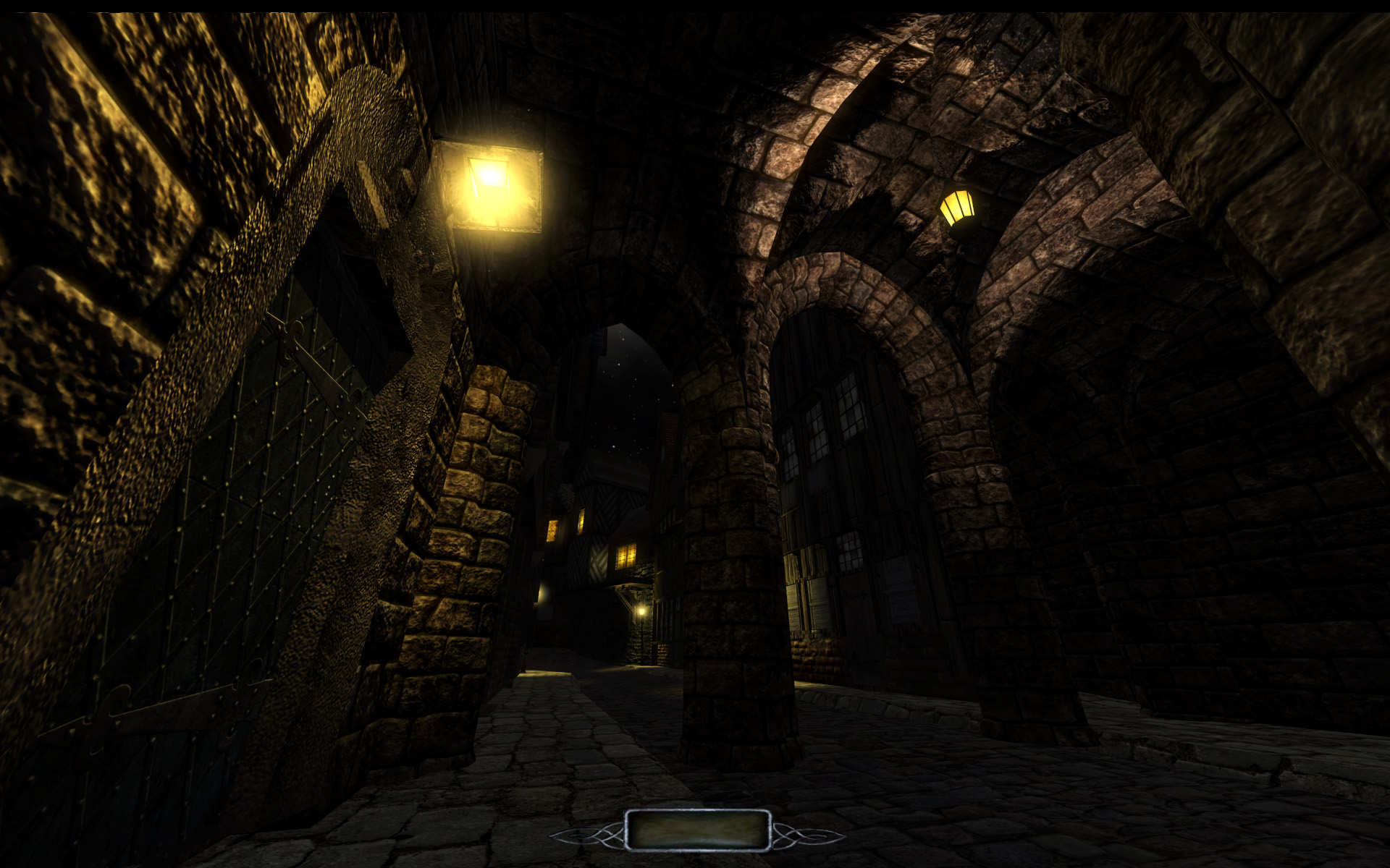

An example of the kind of content i got this screen for: http://www.pcgames.de/screenshots/original/2011/12/Dragon_1.jpg
