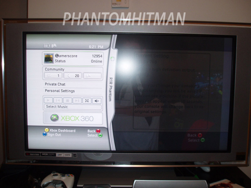

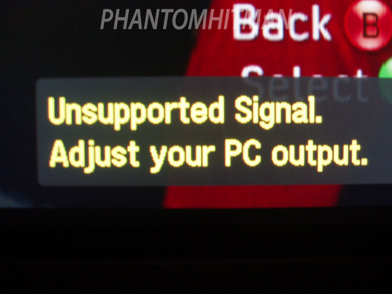

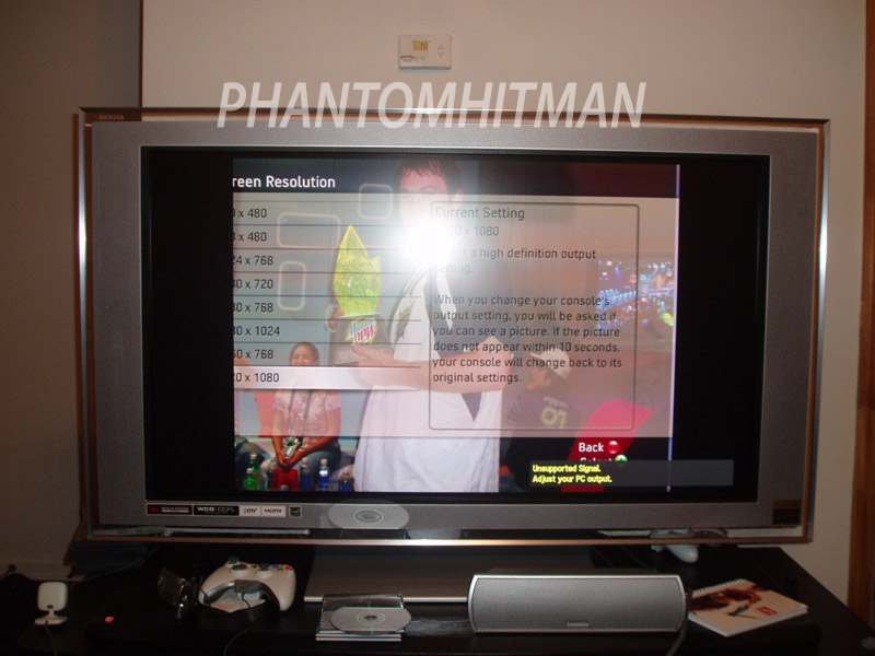

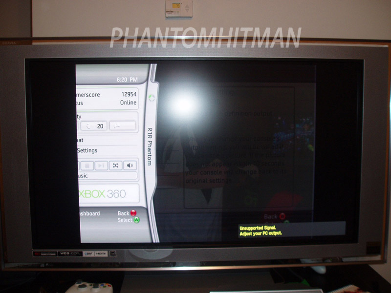

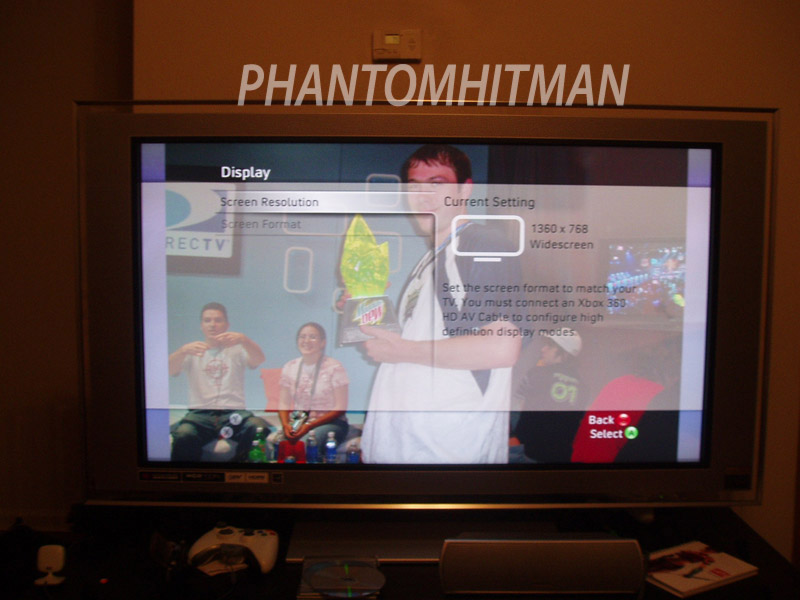

Here is the examples of what is going on.
Sony kdl-xbr2 46 inch
XBOX 360 via vga cable
First, this is 1360x768 which is 720p
Dashboard displays fine, no issues at all
Guide comes up, everything is visable
Next is the 1920x1080 which is 1080p
This the the warning message that appears as soon as the tv receives teh 1080p signal
Here is the screwed up dashboard. As you can see the 1080p image is there but it is almost displayed as a 4:3 image.
This shot shows exactly how much of the 1080p image is being cut off of the left side.
The 1080p image is there, but it is showing only a 4:3 shot of it. You can manually scroll over to the left to see the rest of the image but it will never be in the correct widescreen 1080p format. Microsoft and Sony have exactly one week to fix this before I move along and return this tv and cancel my hd-dvd order.
