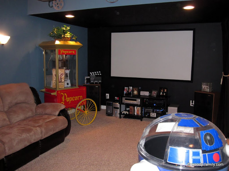

I am using FG for my screen and I made it out of a 4x8 piece. I was able to get a 96in screen made from that size sheet. I only had to make one cut.
The only problem I see is that track light. You shouldn't have any light source, except the projector, on you screen. At least while you are watching it
post #2668 of 2849
Love your room! Do you have ambient light in your room too? What PJ are you using?
Don't worry, the track lighting won't be on when the PJ is on I might actually do back-lit LED lighting behind the screen though. I have them sitting around doing nothing so I'd just need to pick up a power supply ...

I have some ambient light in my room, but not a whole lot. All the lights are on dimmers.
I picked FG because I wanted better black levels than I was getting with a white screen. My projector is an Infocus SP5000 (720P).
