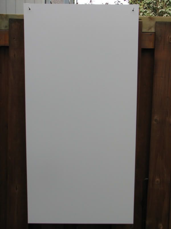

Here is the Black Panel + 1 Coat:
Here is the Whiteboard + 1 Coat:
The first coat usually doesn't look too good but the whiteboard looks pretty good. The black always looks worse. I think I'm getting better at painting metallics with a roller!
The Morning After
I checked the samples this morning and observed that the finish much flatter than my previous attempts. I "think" I may have used the UPW Flat Enamel the first time around. I'm not sure if it would make that much difference. The surface looks smooth and the metallics are visible under bright light from a few inches.
The last time I tried to make up samples of RS-MaxxMudd I had applied each coat about an hour apart. I have since learned that this is not the right thing to do, so this time I will paint one coat each evening until 3 coats and then on the next night look at it under the projector light.

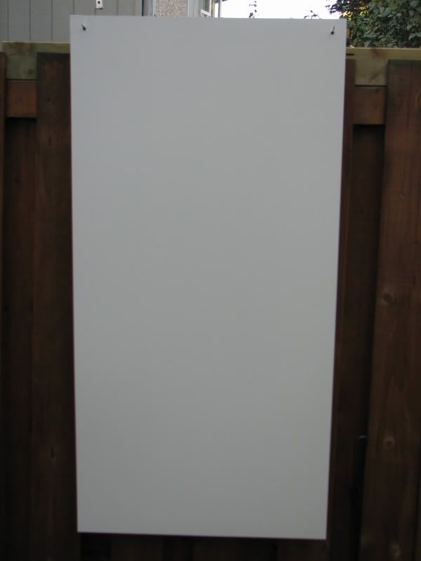

Here is the Black Panel + 2 Coats:
Here is the Whiteboard + 2 Coats:

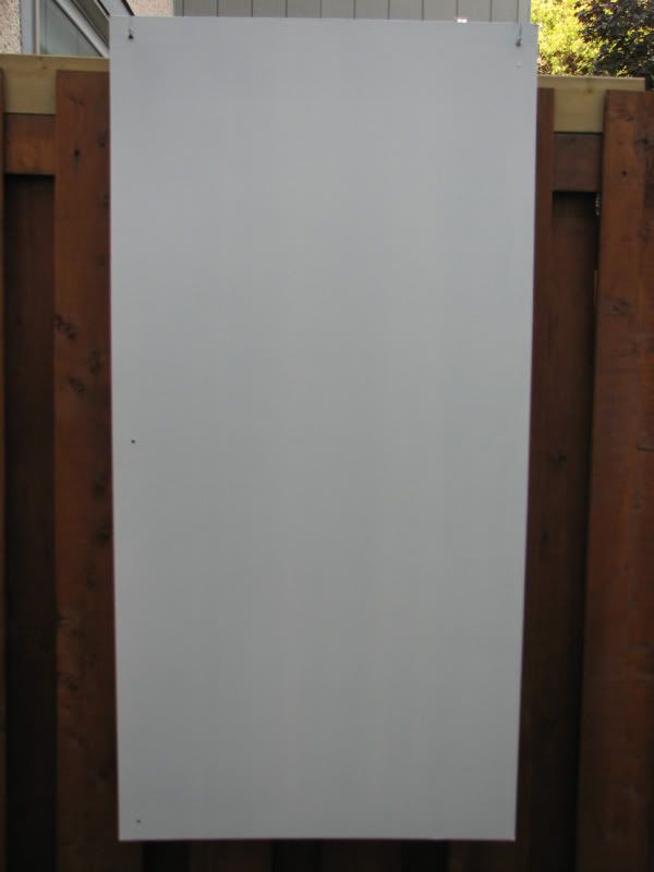

Here is the Black Panel + 3 Coats:
Here is the Whiteboard + 3 Coats:
The black base panel is starting to look better. Tomorrow we will see under the projector light how it looks.
