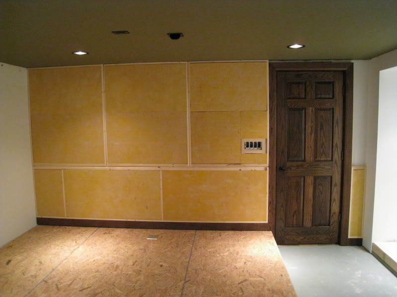

Gonzo,
I went back and re-read the part where you did the frames to cover the 3" OC703 and realized that you put the insulation up prior to putting up the frames.
Since this is the part I am working on now I had a question. First off I like the velcro idea and will try to incorporate that into my frames. I think I will have to go back and add a spot to staple the velcro to.
I was planning to press fit the insulation right into the frame but now that I see you put it up before the frame it has me thinking that you might have used the better method. Would you use that method again or do you think that what you did worked the best? It seems the biggest thing is to trim the OC703 so it doesn't get in the way of the frame as you attach it to the wall.

The way I did worked fine in the end. For some reason I have a neurosis where by I need to be able to easily undo what ever I do. Thus, if I wanted to it would be easy to take everything down and redo the room. I know, I know, I am weird that way. You are right that I had to trim the OC a little to make sure the frames fit well. Most of them would stay in place just by friction, but the Velcro makes certain that they are not going to move.
The front 2 side panels I put the OC into the frame and hung the frames/OC as a single unit. All the others I attached the OC directly to the wall and put the frames up afterward. If I did not do the front two in this fashion, I would not of been able to remove the black proscenium frames (the OC on the wall would of prevented me from being able to pull the black frames off).
In the end, I think either route will end up with the same end result. The only advantage I see to my method is the ability to undo thing fairly easily (verses attaching the fabric to the frames that are permanently attached to the wall).
