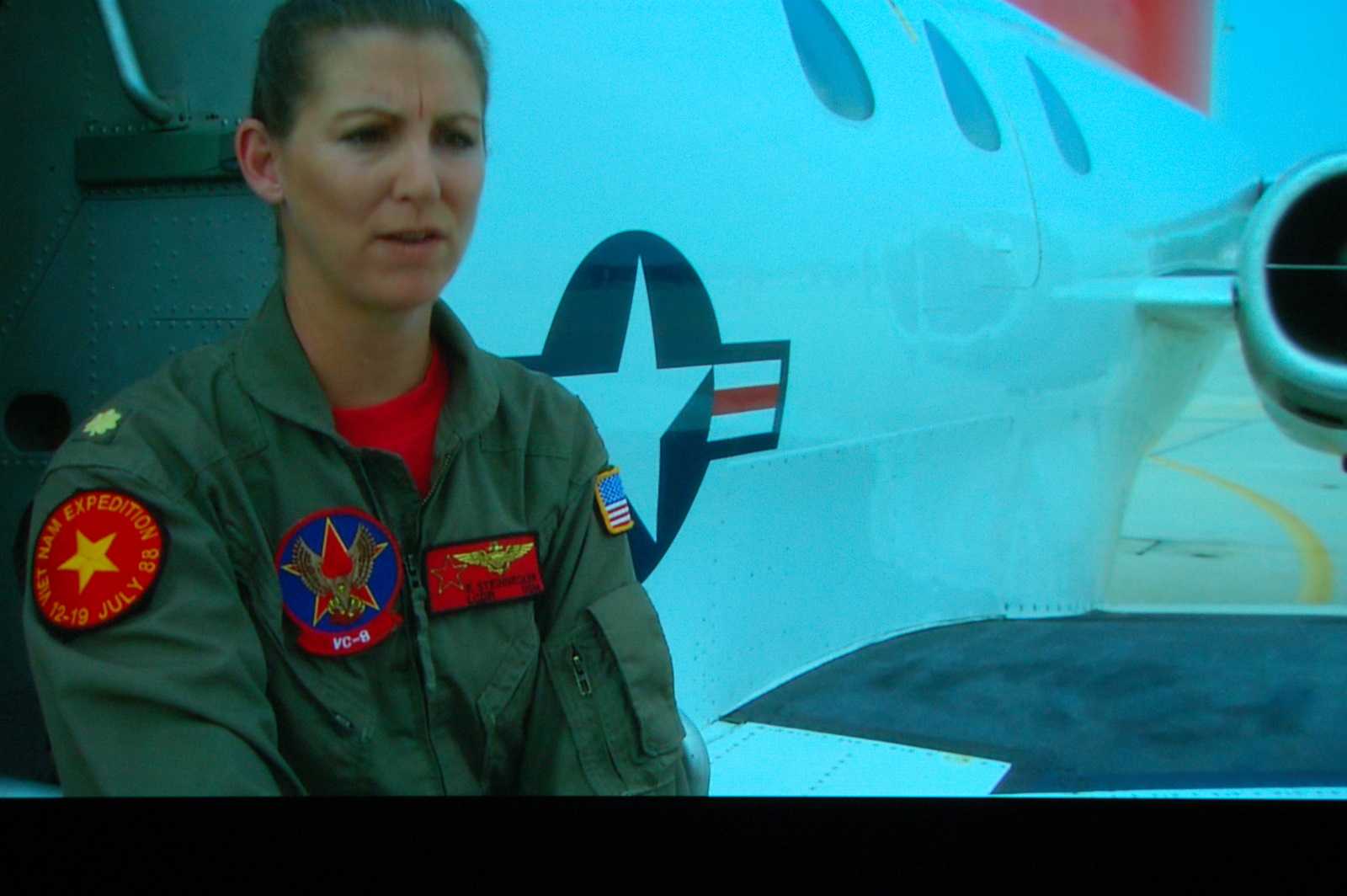

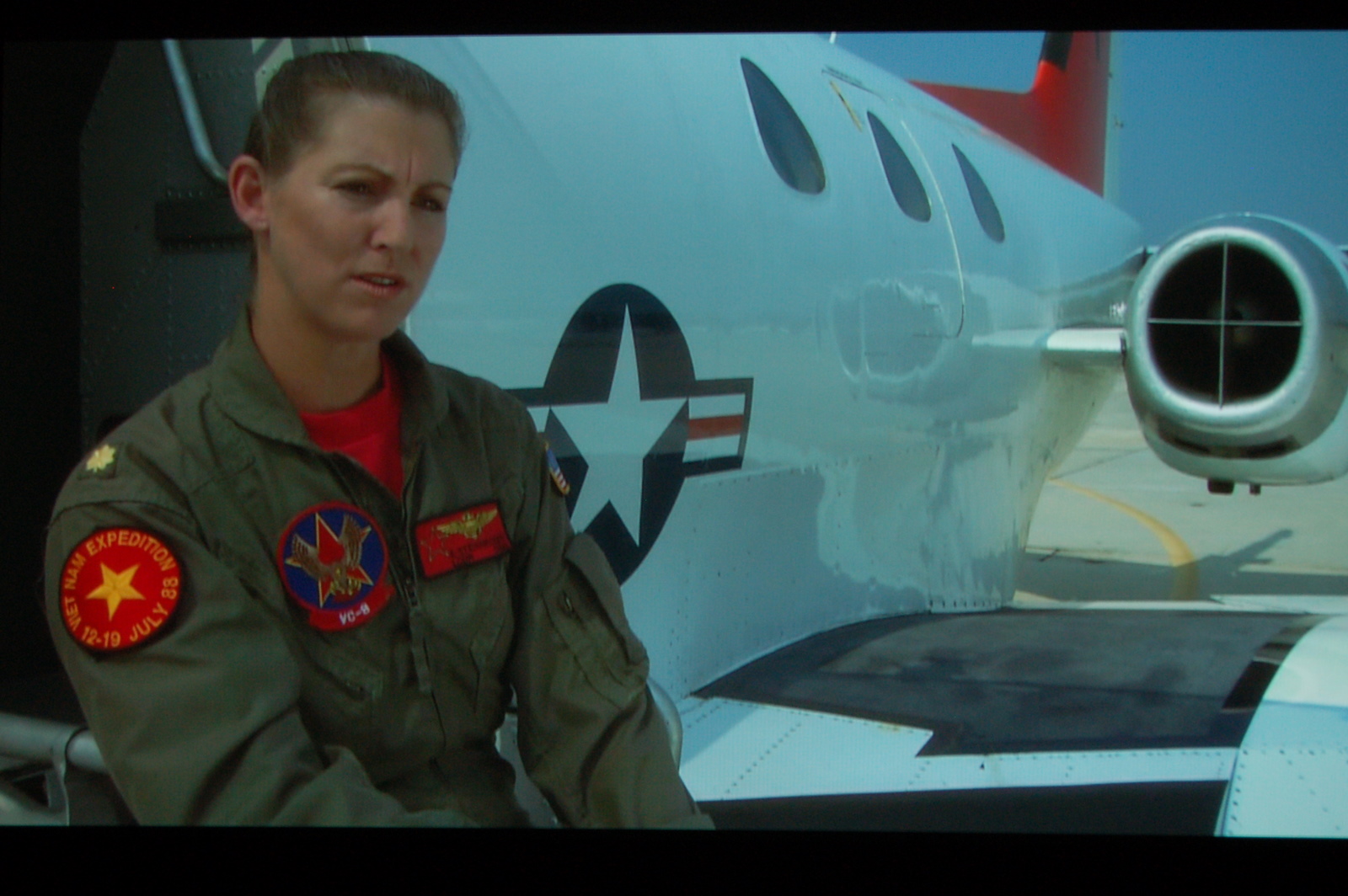

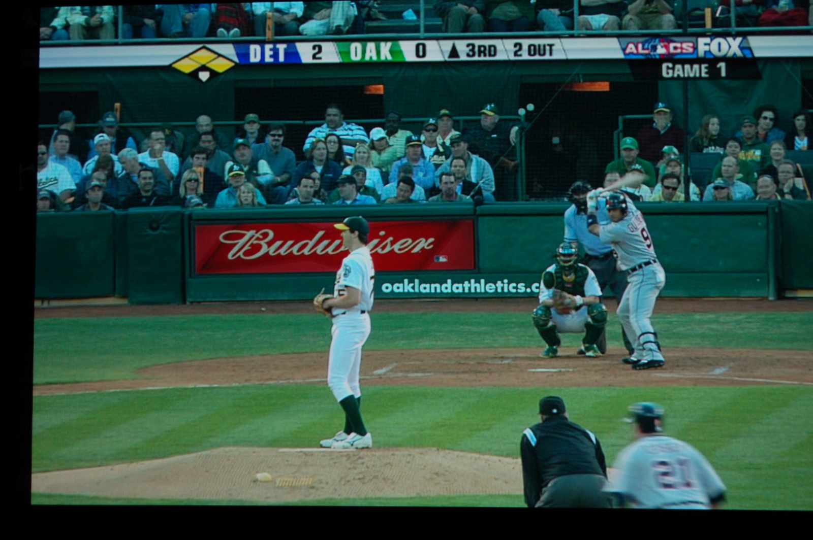

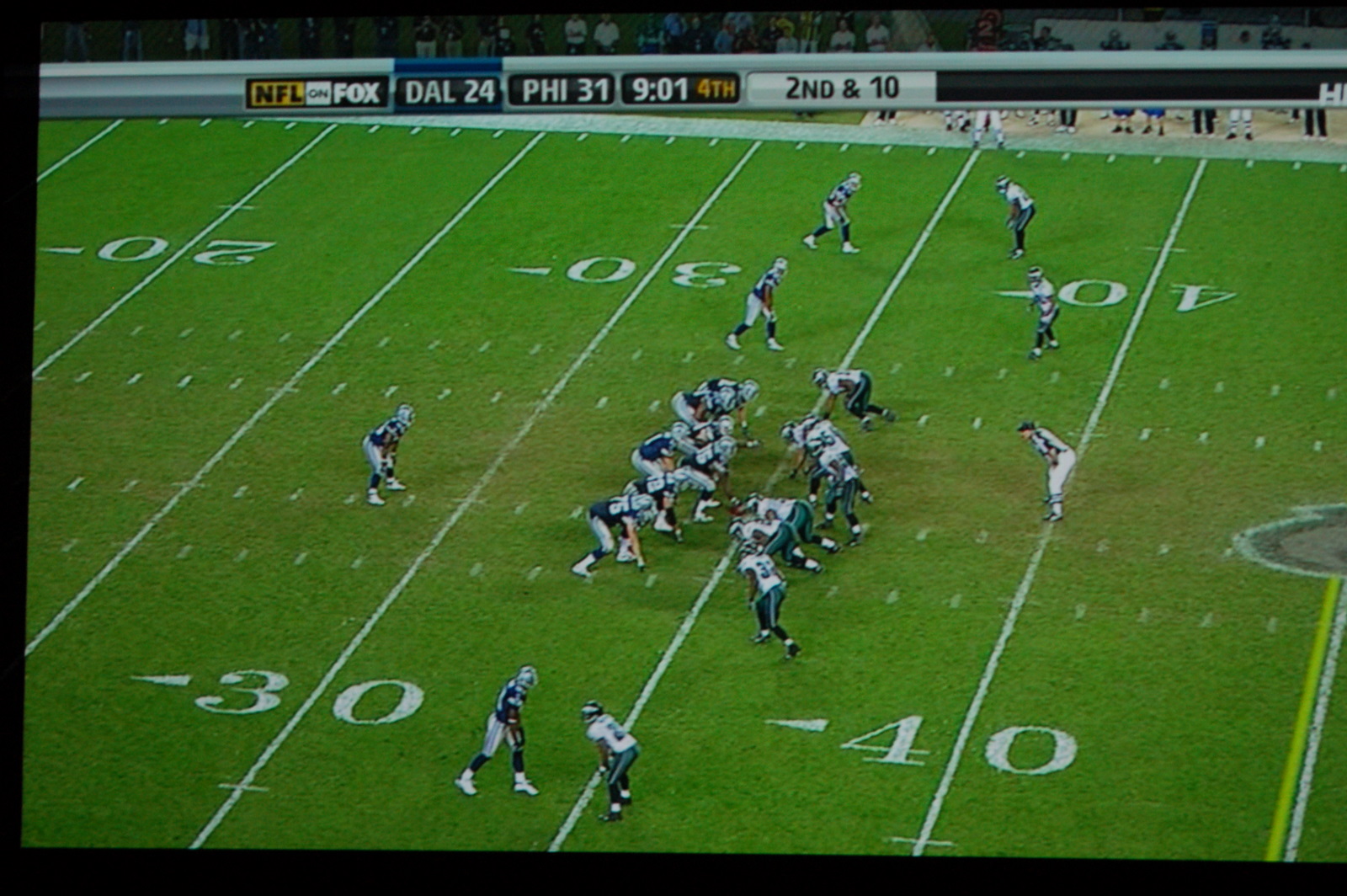

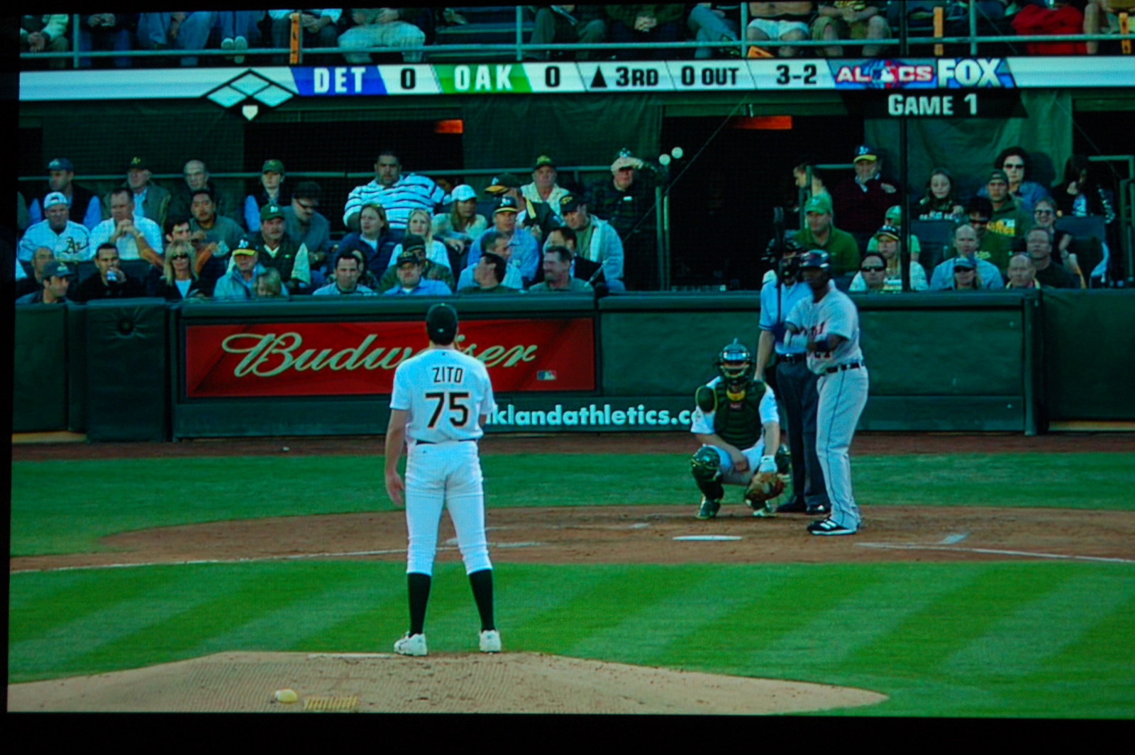

Alright...just used both Blitz's and RedDog's numbers from this thread.
Here is a screenshot comparison. Yeah, I know, screenies are for weenies right? I don't have any meters or what-nots, so these will have to tell the story. Blitz's were still crazy on my setup, even greater blown out greens than OTB. Some channels and shows looked fine...I guess, until you hit greens and yellows in the pic. RedDog's numbers seemed a bit more realistic, but almost too faded, and the image came across as grainy in my book...maybe this is the CR hit that happens when you get closer to realistic colors.
http://websnappy.com/imagehost/PJCom...D70_Blitz1.JPG
http://websnappy.com/imagehost/PJCom...70_RedDog1.JPG
http://websnappy.com/imagehost/PJCom...D70_Blitz2.JPG
http://websnappy.com/imagehost/PJCom...70_RedDog2.JPG
http://websnappy.com/imagehost/PJCom...D70_Blitz3.JPG
http://websnappy.com/imagehost/PJCom...70_RedDog3.JPG
http://websnappy.com/imagehost/PJCom...D70_Blitz4.JPG
http://websnappy.com/imagehost/PJCom...70_RedDog4.JPG
http://websnappy.com/imagehost/PJCom...D70_Blitz5.JPG
http://websnappy.com/imagehost/PJCom...70_RedDog5.JPG
They aren't an exact comparison...I don't have the HD-DVR in the basement, but they are of the same channels. One is NFLHD, one is FOXHD, and the other DSCHD. This is over HDMI.

RedDog's looks spectacular compared to the blitz images. I can't believe you think that's too faded!!!! You guys must like watching a cartoony image or something lol.
post #259 of 2474
Let me restate...RedDog's settings looked pretty darn good actually. I didn't give his attempts at calibration the credit they deserve. The color is MUCH better than OTB, in fact, I probably would be fine with his settings. The problem is when you see it in motion, you realize that there is a penalty for this accuracy in some way. Is it CR? Is it something else? I don't know. Maybe I just have been blinded by the OTB settings with the crazy BrilliantColor seering ridiculously intense images into my cornea or something.
post #260 of 2474

My gut tells me you've been blinded, but I could be wrong. I think if you really gave it a try, and left it alone for a week or two, you would get used to what the colors are supposed to look like.
There's a reason manufacturers push colors, it's b/c people see brighter colors and think that means better tv!!!! So it's natural to want to gravitate towards the super saturated/bright image.

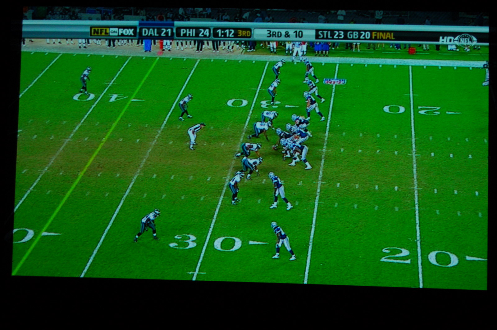

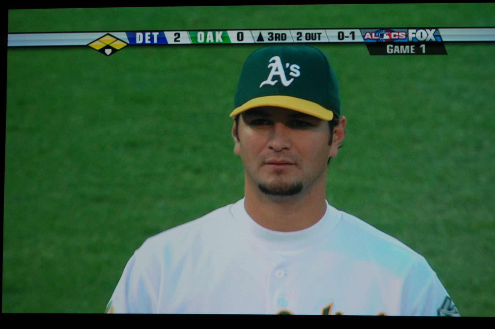

Ya, doesn't look very faded to me either. They actually look still a little too contrasty IMHO. You must definately not be used to watching D65. Of couse this objective opinion is based on screenies so...
Thanks for the comparison.
BTW, that one shot with the airplane in the picture?... is it supposed to be white? Doesn't look white, has blue or green tint or something. I was waiting to see a "RedDog calibration" shot of that plane and there was none. Bummer. I'd like to see that shot comparison of the whites.
Thanks again.
Your wish is my command...the same show cycled through on DSCHD tonight, so I captured one using RedDog's tweaks.
You can use the same link as before, but I'll re-post the links (make sure you hit refresh on your browser if the HD70 image isn't of the LCDR and the airplane!):
Blitz's cal = awful on my machine
RedDog = Maybe this will do it for me. I'd love to see what Kraz's results produced.
BTW, I may not be completely used to D65, but I certainly notice the bad color on this PJ OTB. And why does BrilliantColor make such a drastic change to color even from 0-1? Yeah, the added "punch" can be nice, but it changes the colors drastically!

WyattERP
Brilliant Color is blowing out the peak whites - the control varies how brite it gets and how far down in white it goes. It exposes more of the natively flourescent cyan lamp - I presume thru a clear segment. It also increases the gamma - which shortchanges highlites and shadows for more subjective contrast - combined with increased real contrast. This is most telling in the plane pic - in which the white clearly color shifts - as well as loses highlite detail in the reflections.
Brilliant Color 0 - is not off - unless you also turn down the contrast.
Secondary colors are dependent on the white point - which is why I suggested calibrating using the 75IRE and 100IRE colorbars.
BrilliantColor is a name changed from the white peaking that TI used to call the control - because some marketing guy at TI also noted that brighter whites can also be used to make brighter colors - which are "supposedly" more brilliant....
Calibration requires turning down green and blue gains significantly. This will lower measured contrast for less pop. Also if the bit depth is not sufficient in the RGB gain controls - that can give you a grainy posterized look. You are basically compressing the dynamic range digitally. Consider your digital audio processor that has a digital vs. analog volume control - even if it is 16b audio - if you turn it down -6dB you are down to 14b audio. So some of the bits are going to be the same when they used to bit different - thus the grainyness.
They make analog RGB gains - it is what you call a CRT!
Did you readjust for your sources black and white levels - digital should be the same - but you never know!
Also there is no telling if your lamp is is more blue or more green than RedDogs - so his adjustments will not be calibrating yours. Obviously it is toning down your greens. But try the colorbars trick - you will get your orange right eventually!
RedDog actually has RGBcalibration settings from me for component vs. HDMI because they are different, as well as low vs. high lamp mode - which are also different greyscales. I also gave him a perfect calibration - and a "popped" calibration on top of those. And to top it all of I put blitz6speed's settings into the box before I sent it back

post #265 of 2474
Originally Posted by fru View Post
I am a first time projector owner and a total noobie. I just set up my hd70 yesterday and I see the green push all over. I am using a Panasonic dvd player and components to connect.
Can somebody tell me what settings to use for colors so that the green push goes away.
You could take a look at backing off the tint control. More advanced method is to increase the opposite colors with the RGB gain & bias. You see green then increase red & blue.
