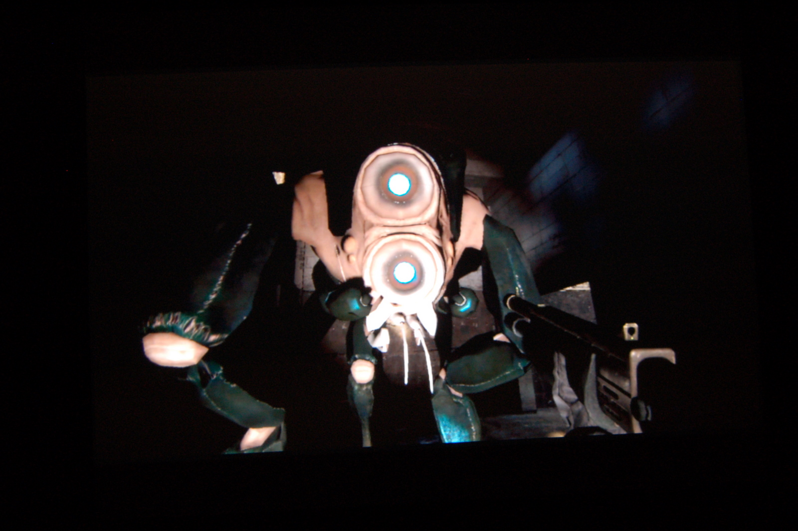

Originally Posted by WyattERP View Post
Alright, a couple images posted. This is my Xbox 360 hooked up via VGA cable @ 1280x720 REZ. All pictures are 1600x1200.
Dashboard Captures:
http://websnappy.com/imagehost/PJCom...0Dash_4805.JPG
http://websnappy.com/imagehost/PJCom...0Dash_HD70.JPG
http://websnappy.com/imagehost/PJCom...ignIN_4805.JPG
http://websnappy.com/imagehost/PJCom...ignIN_HD70.JPG
http://websnappy.com/imagehost/PJCom...eLogo_4805.JPG
http://websnappy.com/imagehost/PJCom...eLogo_HD70.JPG
http://websnappy.com/imagehost/PJCom...utton_4805.JPG
http://websnappy.com/imagehost/PJCom...utton_HD70.JPG
http://websnappy.com/imagehost/PJCom...lades_4805.JPG
http://websnappy.com/imagehost/PJCom...lades_HD70.JPG
HD Game Video Captures:
http://websnappy.com/imagehost/PJCom...eeze1_4805.JPG
http://websnappy.com/imagehost/PJCom...eeze1_HD70.JPG
http://websnappy.com/imagehost/PJCom...eeze2_4805.JPG
http://websnappy.com/imagehost/PJCom...eeze2_HD70.JPG
HDTV:
http://websnappy.com/imagehost/PJCom...board_4805.JPG
http://websnappy.com/imagehost/PJCom...board_HD70.JPG
http://websnappy.com/imagehost/PJCom...lGame_4805.JPG
http://websnappy.com/imagehost/PJCom...lGame_HD70.JPG
http://websnappy.com/imagehost/PJCom...layer_4805.JPG
http://websnappy.com/imagehost/PJCom...layer_HD70.JPG
I realize that some of these pictures aren't the greatest...it's hard to capture motion in a dark environment with a camera, but I think it's a pretty good representation of comparison shots across the board. I have some more coming up once I can get some more content in there.
I think the best comparison shot is the Freeze1 one from HL2. You can see the contrast and sharpness inrease is pretty dramatic in certain parts of the image.
Ummm, websnappy wants a username and password... ERROR 401: UNAUTHORIZED.

Ooops...sorry folks. I just removed the folder restriction on my website. I tried to set it up originally so that I could just give people root access FTP style. Give the change 30 minutes and it should permeate through my site. If not, you can use usernameublic and passjcompare to see the images.
post #88 of 2474
Have you calibrated your HD70?
Just from looking at the pics, you can tell the 4805 is oversaturated by a huge margin. But your HD70 shots show a green push, albiet much more lifelike colors.
post #89 of 2474

WyattERP, I think there may be a Lepricahn living in your PJ. Wayyy tooo much green. Thanks for the screenies though.
