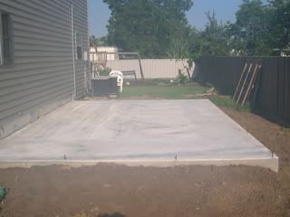

Finally figured out how to put some pictures up so here it goes. These are just a few pictures of my home theater being built.
Outside pictures first
Cement poured
