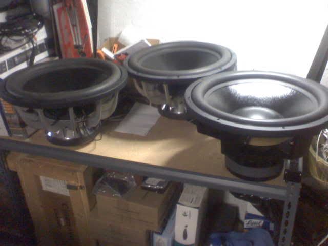

The heart and soul of the project has arrived: a Pair of brand new Ascendant Audio Avalanche 18" drivers....dont ask how I got them or how much I payed for them....just know that I was lucky enough to land them. For about less than one single LMS5400 I was able to land both of these, so as much as I would have loved to be the first to build a pair of large Low Tuned EBS sonotube LLTs (insert favorite acronym here) using the TC drivers, this is a blessing in the sky that such made to fit drivers like these appeared in the sky! heheh.
Yes, the suckers are HUGE, and if the relatively modest AV15 was able to reproduce bass of the quality and magnitude as my DIY box did, I can only imagine what these two towers will do! Some eye candy for you fellas now:
As I finalize the tune point, and get more parts in, and construction begins at Chuck's, we will post it up for you......

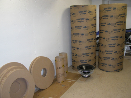

Most parts are in order....the biggest lagger is the actual 28" sonotube, as it is still a coupl of weeks away
The amp situation is a bit in limbo too as Chuck and I are discussing the EP2500 situation...so we may have to order a new one, or something.

yeah, they will be 600L+ each... 6'x28" sonos each.
As I mentioned, tuning is still not final, but I'm guessing I'll probably go with the 12.3 tune, maybe even lower...I modelled the 11hz and it looks pretty good with a slight decrease in overall headroom (barely noticeable) while yeilding good extension near single digits.
My room is not very acoustically friendly, but it yields slightly better gain down low than originally thought...bass traps and so on helped:
