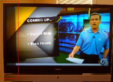

Hi Guys,
I have a Samsung HL-R6768WX/XAA DLP TV. I got the infamous Grey Bar. I called Samsung and they said that they would send a service tech to my house. If it is the light tunnel then they'll change it out free of charge, but if its not the light tunnel, I have to pay for the guy coming out.
This is what it looks like, can you confirm that this is the light tunnel issue?
post #2511 of 2602
Yep, looks like the dreaded shadow to me.
-ML
