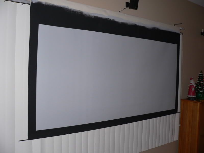

I actually have gone through several iterations. I think I have found a material that works really well. It is a vinyl fabric (vinyl on one side, fabric backing). I recently painted the material, and have a simple fiberglass rod through the bottom. I really don't suffer from waves at all. What I am concerned about is horizontal banding of the screen caused by screen memory after the screen has been rolled up for an extended period of time. Anyway, here are fresh pictures taken tonight:

You have done a great job and have made a successful screen. I think the bigger roller will cure the screen memory issue. Maybe the smaller roller is causing the material to be wound tighter on the roller and then increasing those memory effects? The material that I want to use needs the bigger roller to stay flat. I have spoken with the guy who sold me the screen that I have and has made several of these screens. He says that the bigger the roller, the flatter my material will be. I am using woven acoustically transparent materials. My motor is on the way. It is a two pole motor so I beieve that I can wire it to one of the Da-lite radio control set-ups and be able to retract the screen from a distance. I know the basic 12volt trigger module will work with this motor. I have wired a few Da-lite electric screens and they have the exact wiring as this motor. The problem with using a bigger roller is that you need a more powerful motor to rotate the roller.

You are probably right about the bigger roller being less susceptible to causing "memory" problems but the problem can also be associated with how you attach the material to the roller... the transistion has to be very "clean" with little or detectable different as the material rolls over top. In addition, it helps if you have a large section of border / margin that can wrap around the roller a "few times" before you get to your screen / viewing area. Also the type of material is important... vinyl based material tends "imprint" easier that fabric based materials. As for waves, I think that you can readily fashion your own tab tensioned system if you have seen a commercial one "up close". They are actually pretty straight forward. Since the material you are planning on using is woven it might be a bit stiffer that vinyl and as such you might get lucky and not need much help in avoiding waves with your "large roller" plan. If you can, I would leave a large amount of space / room at each end of your roller, just in case, you need some form of tensioning which could be added if there is room on the end of your roller.

I left the screen up overnight, and when I retracted, there was slight memory toward the bottom of the screen--right about the place where the screen, if not full retracted, hangs slight down from the roller. Where the transition point between the rolled part of the screen, and the little bit that hangs down--this is where the memory was. However, within two minutes, the screen was perfectly flat again. The vinyl may be soft, but any memory quickly falls out.

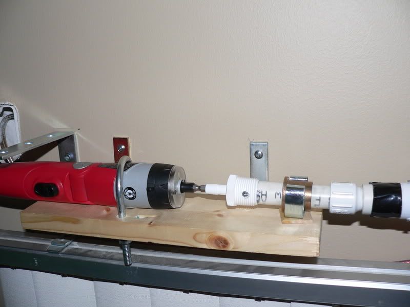

Going this route was easier for me. The motor has built in adjustments that will limit how high it will raise the screen and how low. I do not have to engineer any solutions this way. Just put the motor in the tube, mount the fabric on the tube, set the limits and wire the switch. I plan to wire a second motor for masking. I am going to have a second roller that will lower black masking to make the screen go from 16:9 to 2:35. Got my motor in a few mins. ago. This motor is over-kill. I would have saved 50.00 by going with a much lower powered motor but this motor is designed to go in the size tube that I want. Tiddler, I think we are at two opposite ends of the DIY electric screen thing. I am thinking masking and radio control. Da-lite pull downs are just too cheap for me to build a manual screen. I gave the last one I had away to a friend.

Good idea--about the limits. THis is something I struggle with. Right now, with my valence, I have just enough screen to come down and fit the image perfectly in the black border. Any further down will roll the screen too far and damage where I have the screen attached to the rod. I think what I really need to do is bring the border down a few inches or so so that I don't have to walk this fine line every time the screen comes down.

Wired the motor to the switch to make sure it worked and to see how noisy it was. Sounds about like the motor in the Da-lite Tensioned Electrol that I owned, not silent but not too objectionable. This motor is rather large compared to the small Somfy motor that my current screen uses. It is about 2.5 inches in diameter and 2 feet long. Weight is about 12 pounds. Rotation is also rather slow at about 15 revolutions per min. Should take about 1 min to raise 60 inches on 4 inch diameter tube? My tube samples have not gotten in yet. The motor did not come with a cap for the other end of the tube. I am purchasing a crown to put on that end from a Somfy dealer.
