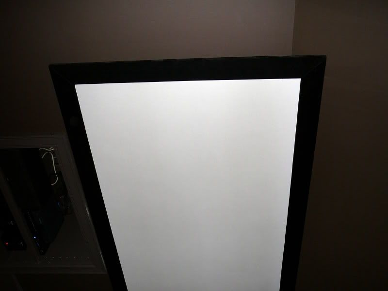

Below are shots taken of a "SandiPly" Plywood sheet 72" x 39" in size that i used as my "Test" palatte when getting accustomed to spraying to Bob Seager.
I thought it wise to do my first squirt on something a little less permanent than a 124' wall surface.
If anything, I started out using greater care than necessary, knowing that "too little' paint applied could always be corrected. This board also received 4 coats of Kilz-2. SandiPly plywood is both a multi-ply finish grade material and so is very smooth, and I thought it could be an alternative material when something "wood' was needed, so thats why it was choosen as my "test bed".
All in all, it worked fine.
But the nature of the Glaze / Silver mix it to accentuate ANY defect on a surface. In this shot, everything appears fine;
But when you get your nose up close, and hit the surface with a high intensity light such as you see I was using, the "Nasty' rears it's ugliness.
Strangely enough, when a projected image is upon the screen, even close scrutiny cannot ascertain the scratches that seem like "Territorial Bear Claw Markings" you see magnified above. The difference is so striking between what you see illustrated above in directly applied side lighting, and what can be seen under 'normal' viewing conditions, that I would not be agast or even hesitant to use this particular surface. I'd hate to see it go to waste, so.................. stay tuned!

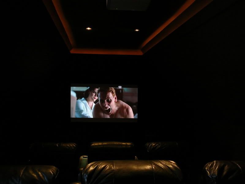

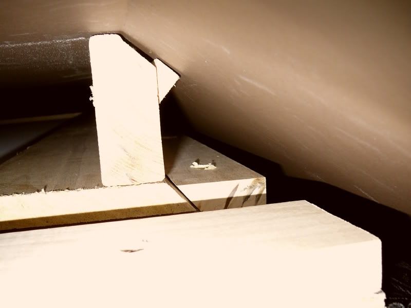

This is the Room. A small, narrow Bonus Room over a garage. 20' deep -x- 11' wide, with 40" Knee Walls and a "supposedly" 45 degree sloped ceiling.
It is hung via a 65" long French Cleat affair, with the "Wall Mounted" section of the French Cleat being a 1" x 8" and the opposing 65" "Screen Mounted" French Cleat being a 1" x 4". This is how the French Cleat hanging system looks from the side.
With Velvet Trim applied, the appearance of the screen "Floating" is not an illusion, it is in fact suspended away from the wall on all sides.

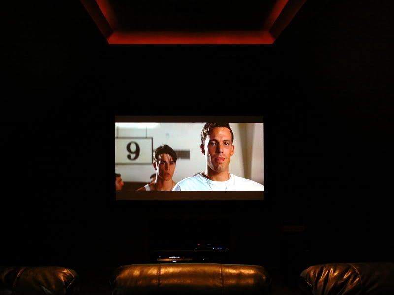

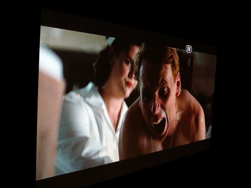

A S-I-L-V-E-R screenie taken from 22" back, on "Auto".
Same frame, taken from the side at 120 degrees
Ben Affleck, @ 14' and looking as good as possible (....for him, anyway. Less Jenny.)

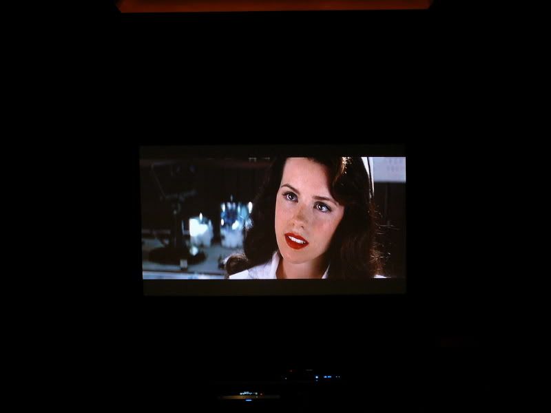

And lastly, a shot of something just as pretty as can be, made "Mo bedder" by S-I-L-V-E-R
