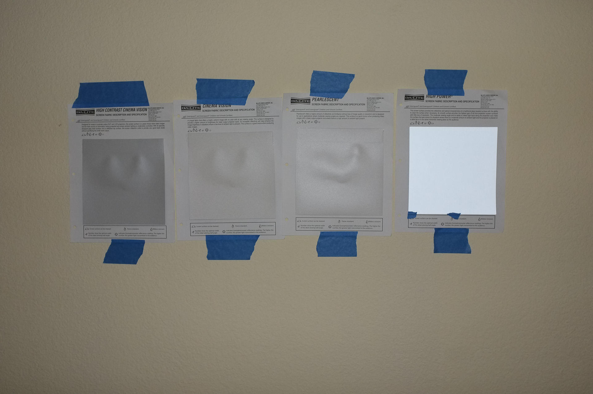

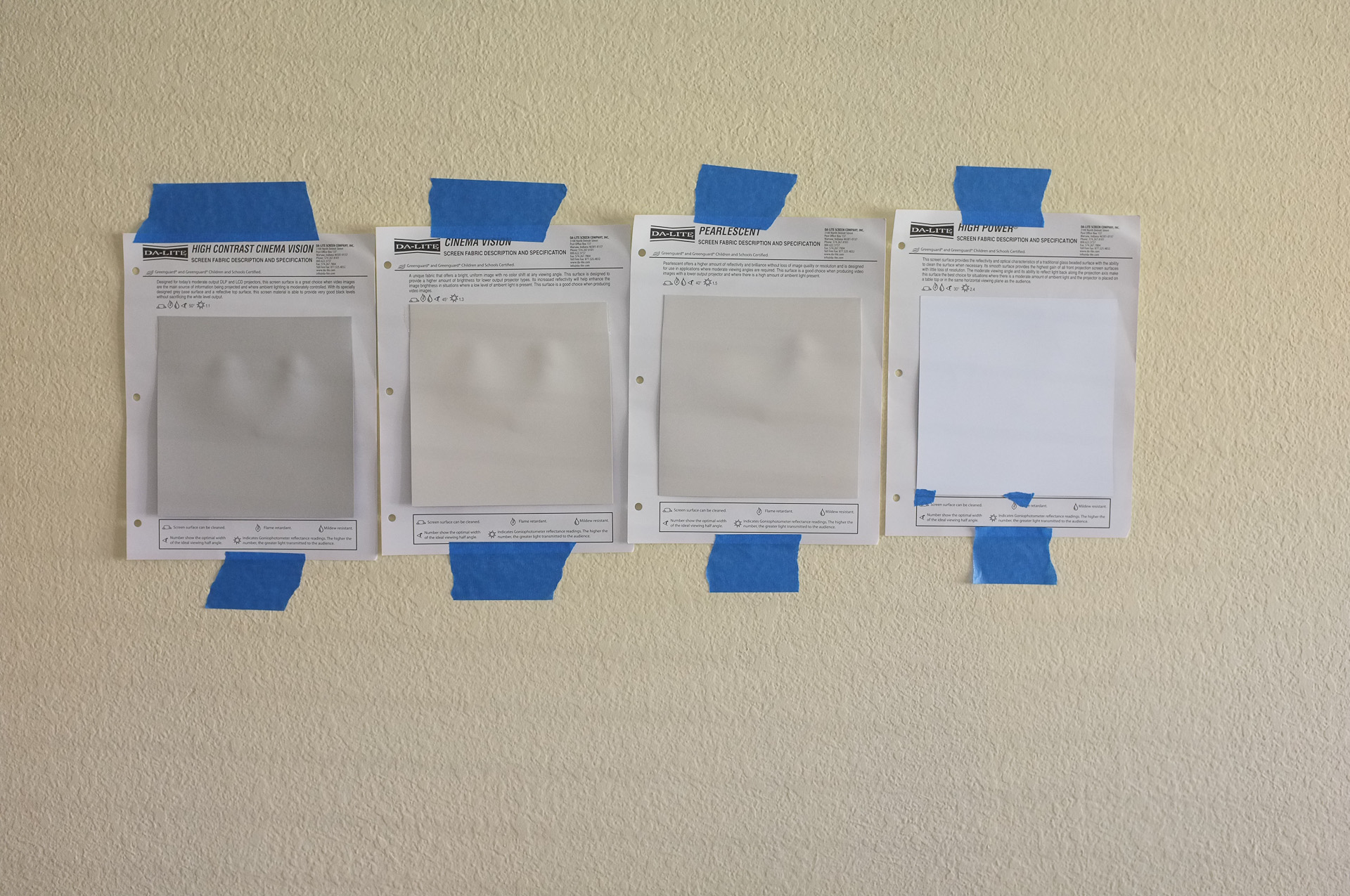

Right, I forgot there are other types of screens Plus it would still be possible they included the right tool but the wrong screen fabric.
Here are some pictures I took when Da-lite sent me samples. The first one shows what they look like with light coming from the side, and the second one was taken with a flash, showing the magic of the high power fabric.
http://www.datamagic.com/da-lite/off-angle.jpg
http://www.datamagic.com/da-lite/on-angle.jpg
