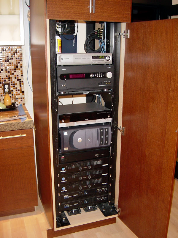

My rack built into an IKIA cabinet. On castors so you can roll it out and get to the back. It's attached to the mini-bar outside the theater.

That looks nice snooprob. Are there real rails in there too, or did you use the Ikea shelving...it looks like real rack parts. What's the Ikea product name ('Racken'...'Shelven', something like that?)

Thanks, and you should do names for IKEA, I think you have a knack for it! I don't recall the actual model but the link below sure looks similar. I did put normal rack rails inside, but they did not allow me 19" between them when installed... So I had to cut off about 1/2" on each side removing all the pre-threaded holes. Not ideal but I am very happy with the stability, accessability and looks. The price was tough to beat.
