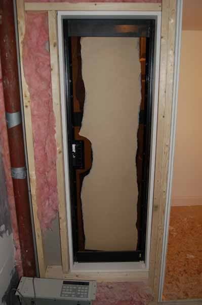

Anyways, they did cut the hole for the EQ rack (the opening on the left by the theater entrance):
Here it is from w/i the utility room:

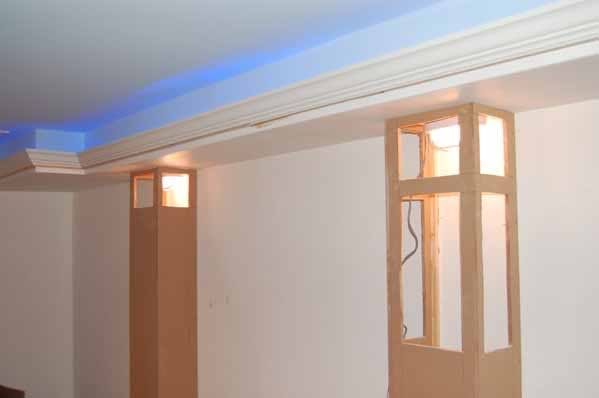

Here is a column that has been cut for both a speaker and the "sconce". The plan is that we will add frosted glass to the light openings, and wrap the column with expocloth holding the speaker. Need to stuff the some of the columns with insulation, figure out access for changing light bulbs or speakers, and add a separator between the light and the rest of the column to prevent light spill, etc.
Here is the side wall. The column closer to the screen doesn't hold a speaker, so just an opening for the light:

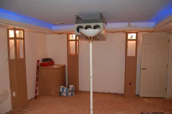

Here is the back wall with a floor lamp in the pic. Sorry about that. In the rear corner is a cabinet that houses the sump pit. It is 36" high, and I am re-thinking that height, may scale it down, its kind of imposing. Maybe one day we'll throw a popcorn maker on there.

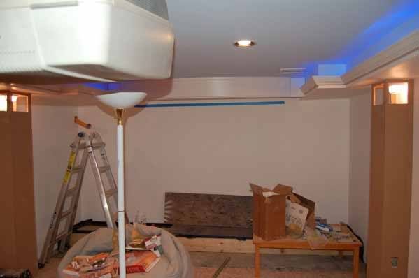

Here is a shot of the front wall:

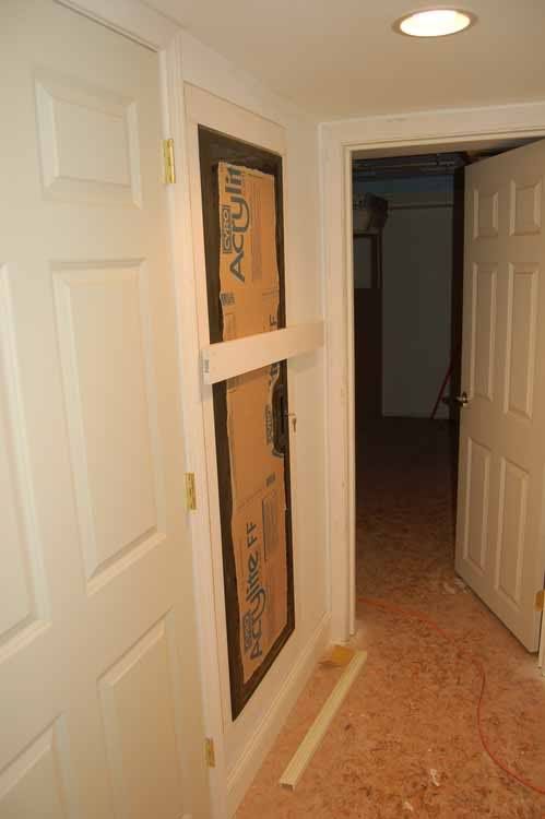

Just outside the room now, here is the rack. No hinges, so the door is held in place by conventional means. The trim was placed to set the door within the trim, but we might change that so that the door closes over. Also the trim is too wide.
Here is the rack in the utility room. Not much to see here right now.
