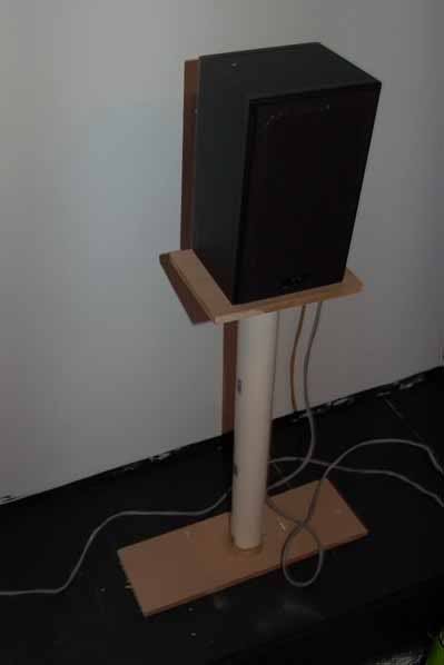

In the last few days I have been trying to make it through CRT setup guides. I did manage to cobble together some ghetto speaker stands. They will be behind a fabric wall so aesthetics are immaterial. One part scrap mdf, some pvc pipes, sand and glue. It will do. I may spray paint them over the weekend.
