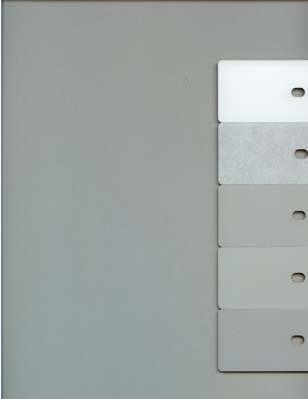

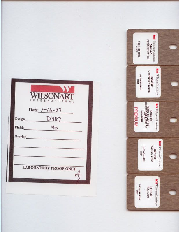

If it interests anybody, I set up a few samples on my flatbed scanner (which in and of itself may be a prime example of a maximum potential under extreme conditions) but may provide some discussion of color/shade/luminosity.

Hi guys-- Just wanted to mention that the screen shots I posted of the PS90 were taken using our ancient Sony ('rated' at 450 lumens) projector. To put things in perspective, I think the strobe flash puts out somewhere around a million or so peak lumens (if memory serves correctly the old flashbulbs were between 1-2 million peak lumens, so this may be conservative).
What was interesting, was that the DaLite screen completely washed out. The PS90 was still viewable, at least according to the camera.
When I picked up the (rolled) sheet, the kid at the yard (outdoors, in daylight) said "That's pearl silver? it doesn't look silver to me." And I checked the numbers roll-printed on the back of the sheet, because it wasn't at all what I was expecting. It looked like a very neutral off-white, not even a gray.
I was a little disappointed, because it just looked like a muddy, matte white. Then, once we got it indoors, one of the guys made the comment about how the surface seems to have 'infinite depth' when your eyes get a couple of feet from a full sheet- you have an urge to reach out and touch it, to see where the surface really begins.
I'd already bought 2 quarts of Behr Matte poly, and turned one into "Tiddler's mix #2", in anticipation of the need to 'knock down' the gloss. But this stuff, despite the glossmeter readings (I think 11-16 was within wilsonart specs) just doesn't look 'glossy'. Maybe its the texture, which DOES resemble a glass-beaded metal surface (except there are no visible metallic sparkles to my aging eyes). I'll look at it under a 5x loupe the next time I get a chance to work on it.
It may be a mix of the RGB values (VERY neutral), the specular gain, the neat texture, or a trick of human visual perception, but right now, I'm thinking I won't even need to coat this stuff. Just to be safe, I'll coat a 2 foot x 2 foot sheet with Behr Matte poly, and another 2x2 sheet with Tiddler's #2.
I'll clip 'em to the untreated sheet, and take some more photos.

And as a quick refresher:
Platinum is 186 179 187
Pearl Silver is 188 182 188
Platinum comes in the matte finish and may not need any topcoats. Pearl Silver does not - Crystal finish only. Color-wise they're virtually indistinguishable. Specularity-wise, there's a big difference.

Actually, Pearl Silver is available in two finishes--
D487-90 is the "crystal" finish I used
D487-7 is the "textured gloss" finish, previously deemed "way too shiny" in this forum (this is the standard Wilsonart finish for all colors, including Fashion Gray).
Which brings up a question-- since the RGB numbers show, as mech stated, that Fashion Gray and Pearl Silver should be "virtually indistinguishable", why does WilsonArt make BOTH colors, instead of settling on one?
I think the answer lies in part in the names of the products-- both look gray, so why call one "Pearl Silver"? It can't be the texture, because both Fashion Gray and Pearl Silver come "standard" in the "-07 textured gloss" finish, which would result in a "virtually identical", not a "virtually indistinguishable" product. There must be another difference- one not related to glossmeter readings or RGB values
My suspicion is that "pearl silver", although it doesn't appear to be pearly or silver, contains reflective ingredients like very fine mica or metal powders in the mix, to give it that "pearly glow". That would account for the seeming extreme luminosity of the samples we've used, as well as some of pjohnson's rhapsodizing over its "magical" qualities. (and yup, in the dark, it looks like a plasma screen--- amazing brightness for our Precambrian-era projector)
It occurs to me that "Pearl Silver's" gain would be similar to some of the translucent reflective multilayer coatings others (Tiddler in particular) have experimented with.
Here's an idea-- when we've committed to a final screen coating (or lack thereof), I'll pay to ship my large samples (about 24" x 32") to anyone with the gear, the time, and the inclination to do some technical comparisons with Fashion Gray, and figure out if there is really any difference, or if the people at WilsonArt need a lesson in production efficiencies.
-bob (UncleScurvy)
