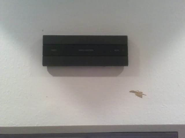

i have a bang and olufsen whole house audio system its 10+years old and i dont have the receiver it costs 20,000$+ so im thinking is there a way i can connect that audio system to a receiver that costs <$1100, i had someone come and check out the system and it has some special wiring thats B&o specific and i wanted to know are there any converters available for it? and the receiver has to be able to handle 5 or 6 rooms with 2 speakers each(prewired with B&O wires, they all dont need to be indepedent zones they can be considered as 2 or more)+ a 7.1 surround sound for my den(maybe i should get a seperate a/v reciver for the 7.1 for the den). and i was thinking about getting one of these:

this is *i think* a remote eye, it says B&O in the center mute on one side and "timer" on the other side

FWIW we had a system just like yours. We removed all the components and sold them on eBay. There is a lively auction market for these legacy B&O whole house systems. The center picture is an IR receiver with 3 buttons. If you're in to eBay and would consider a B&O receiver, try there. HTH. Tom
post #3 of 18
Yes, the box on the wall is a "remote eye", and then some. Its called the Master Control Link 2. It is only compatible with B&0 systems. The good news is that you don't need current B&O gear to use it, and second hand equipment of this vintage can be purchaed quite reasonably on eBay and the like. Tha link below is to an unofficial B&O technical site that has all of the wiring information you are looking for.

There are 4 different components to the system: (1) the head end Beomaster amplifier/receiver, (2) the Master Control Link distribution box, (3) the Master Control Link wall panel, like the one in your picture, and (4) the speakers. A cable goes from the Beomaster to the first distribution box. Two of the wires are for the left channel and 2 for the right channel. Two more carry low voltage to power the distribution boxes and wall panels. I don't recall the voltage but it's between 12 and 24 volts. The final 2 wires carry the control signals from the wall panels back to the Beomaster. The wall panel is wired to the distribution box by a 6 or 8 (I don't recall) conductor cable. The same type of cable that goes from from the Beomaster to the first distribution box is used to daisy chain from the first box to the next box in the system. This continues to the last box in the chain. There are DIP switches in each box to set various parameters including end-of-chain. The system is operated by IR hand-held remotes. The wall panel in your picture has a few button switches to turn the system on and off, a timer, etc. Most of the control comes from the hand-held remote though. The remote can turn the system on and off, select source, adjust volume, etc. Because there is only one pair of wires for the left channel and one for the right in the daisy chain cable, each room must listen to the same source at the same volume. The system works great because it is so simple. No matrix switchers, etc. are needed. HTH. Tom.
