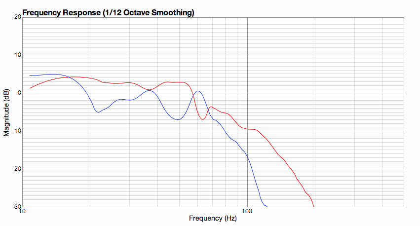

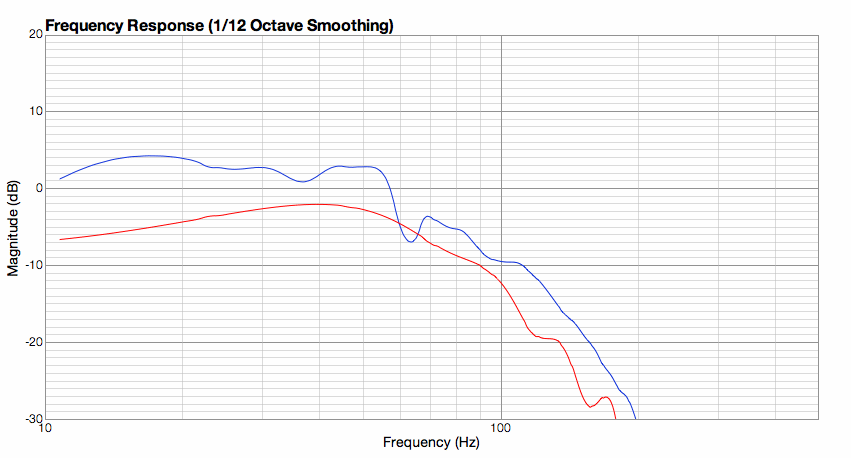

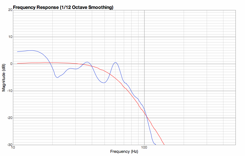

Yes, Chris gave me an update after testing my 1909 yesterday. Don't guess he minds me posting it here:
I tested your AVR today and found that the bitstream input is not working correctly. This happens with MultEQ on or off. It's much more audible with MultEQ on because the bitstream input is totally messing up the MultEQ filter. But, even in the off case it's totally wrong. The PCM input is working perfectly.
Glad someone else was able to see it firsthand! Denon engineering in Japan has been contacted again -- Chris did when I initially reported the MultEQ factor a couple months ago, and the Denon support people (or "senior management") supposedly did a month ago Thursday. Curious to see what comes from them this time...
Another weird thing now, to me, that he measured bitstream being wrong even with MultEQ Off, when what I heard and measured indicated it was identical to PCM without MultEQ. So either something was wrong with my measurements, or some other variable is changing things with Chris' setup.
Here's the measurement graphs from his tests:
MultEQ On-Off (PCM)
MultEQ On-Off (Bitstream)
MultEQ On (PCM-Bitstream) (Seems to be the same flipped/mirror-image response I measured.)
MultEQ On-Off (PCM)
Thanks for posting this Dr P. A couple of questions, if I may (answers may have been given before, but I'm not finding them this morning).
As far as you know, is the MultEQ on and off JUST MultEQ, or is it dynamic EQ?
Do I recall correctly that all your experiments happened to involve Dolby encoding? Do we know either from Chris or your investigations whether DTS suffers from the same errors?
Finally, a comment. While the 2 base curves (no Audyssey) clearly are different, I struggle to put together expactly how the Audyssey changes flow from the different FRs. Maybe it's partly because of smoothing (even though it's 1/12 octave). Maybe I'm just not fully thinking it through. But since all Audyssey sees is the PCM, the FR differences must be the explanation.
