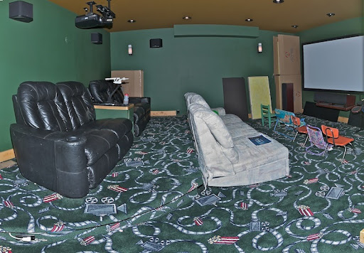

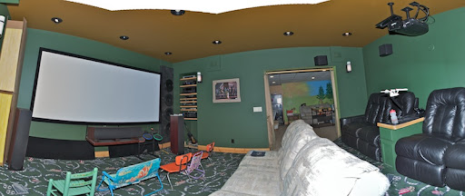

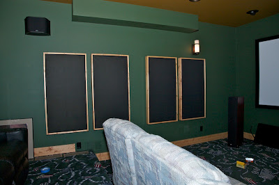

Snow day here in SE Michigan....
I've got a Denon AVR-4308CI (circia Dec-2007, upgraded the Audyssey feature pack), 7.1 spkrs Paradigm v5.0 Frt Monitor Series 9, Center CC-390, Rear/back surrounds ADP-390.
Room size is 18.5' long, 14.5' wide, 8.75' high.
Q1 (this post, Q2 next post):
I've finally started my acoustic panels in the HT and have some Q's related to before/after of the Audyssey info/graphs the AVR-4308CI will display.
Before shots:
LH wall
RH wall:
I plan on handling:
-side walls 1st reflections via OC703 2" thick 2' x 4'panels spaced 2" from the wall
- ceiling 1st reflections via OC705 4" thick 2' x 4'panels spaced 4" from the wall; both 1st row and 2nd row will each get (3) ceiling panels 2' x 4', an "acoustic cloud" 2' x 12' at their needed location.
- adding full floor/ceiling corner bass traps via OC705 superchunk 24" x 24" x 34" to rear wall/ceiling/floor.
-Frt top corner bass trap is tbd, rear wall diffusion is tbd

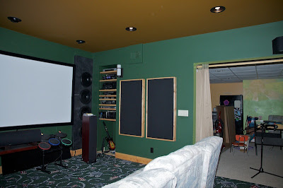

So far, I've made and installed the side wall treatments.
LH side-------------------------------RH side

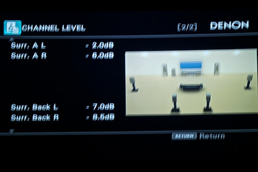

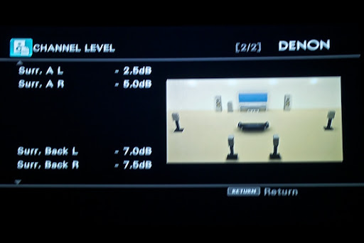

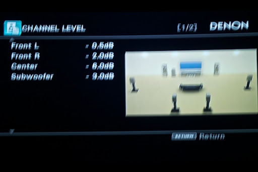

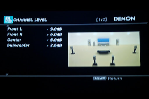

Here are some picts of my Audyssey levels before/after panels installed.
Sorry for blurry, my tripod was not tightened on these 0.4 sec exposures....did not notice till after taken
Baseline-Before acoustics Channel level
After side wall panels installed Channel level
The frt RH/LH mains levels adj up (less -db), all others basically same, which is sorta expected because I did only 3 seat points and that was 2rd row middle seats, so they saw improvements of side panels but center really needs the ceiling treatments also, which I'm doing this weekend.
Q1:
Besides my "guess" above, what else can be garnered by the channel level data?
My RT60 is still to high and Audyssey therefore is "on average" dialing it down (weighted avg of the EQ curves in next post)
I'm also curious my side/back surrounds need so much -db applied, will be interesting to see after the ceiling treatments how they all change...any speculations?
Those wall panels look identical to mine.
Rives?
Mike

My own DIY design using OC703 from ats acoustics, I wanted a rustic look so used 1 x 4 pine + stain and black drywall screws, I've not seen the Rives one.
I'll be posting a DIY construction thread for the "hangable" style acoustic panels, both side wall and ceiling, in the "Dedicated Theater Design & Construction" forum later this week.
Currently there are only threads for Fabric frames, which are integrated as part of the wall itself, not hanging and locatable to where only needed.
For now, here's a post with some details, http://www.avsforum.com/avs-vb/showt...0#post19908230

Here's what I would do:
Gain - about 1/2 way
phase 0
subsonic filter off
crossover over 120hz or disable the crossover.
Audyssey will compensate for wherever the speakers are placed. Don't worry about 2 inches.
Take first audyssey measurement from ear level at your prime listening spot...put the microphone on a tripod away from the back of the sofa/chair. Then take measurements from the other positions you sit in, as long as they are within the focus of the two main front speakers. Take at least 3 measurements...and maybe take 1 at knee height and 2 more about 2' in front of where you sit.
Yes, you want the mid range notch/bump if offered and let dynamic eq default to on (dynamic volume off).
After calibration go in and manually set your speakers (other than the sub) to 80hz crossover point.
Ignore any speaker "out of phase" messages (after you double check your wiring)
Good luck
post #35880 of 62249
For best info see page 1 of this thread.... but basicly:
Gain: Start with 5 (1 - 10)
Phase: 0
Subsonic: on? to filter out the lowest info...
Xover: OFF pref or highest it can go
I personally believe that yes with XT32 a 2" movement of the mic makes a difference so if your moving the speakers down (not necessary) that will make a small difference. Whether you can hear that difference is another thing entirely... But from experience its better to have tweeter level slightly higher than lower and having to aim up etc...
Its fun but a big learning curve especially it seems with XT32 and getting it to sound "just right"
My tip is just do 1 MLP mic calibration, save it and have a look at the graphs / levels / etc and then make any necessary speaker movements, toe in / changes then go back and redo Audyssey with the 8 mic locations....
Don't think of the mic positions as seats but more create a small rectangle "bubble" around the MLP with a few measurments in between the points - if you have a second row include that within the rectangle.
Have fun!
Edit - as ghstudio suggest go back in after audyssey finished and change all speakers to small and xover up to 80hz - if any are higher than that DONT lower them leave them as is.
