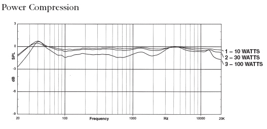

I think this speaker issue is analogous to amplifiers. We all know that a spec of "100 watts" means nothing if we don't know the max distortion or frequency range.
So picture the information we have on speakers like what we had prior to the FTC requiring more qualifiers on amp specs. The manufacturers are usually not telling you how the speaker behaves at the limits of its performance.
Program Peaks
djbluemax1's discussion of XMax and XMech explains how on program peaks, you can reach the magnetic and mechanical limits of the driver. At these high levels, if for example output falls off for bass/midbass drivers, then you can see how there'd be too much treble in the speaker's overall output? This is a nonlinear response at high peak levels.
Program Continuous
For continuous levels of high volume, it's about thermal compression.
At levels that are alarmingly a small fraction (starting at 1/10th) of the speaker's rated continuous power input, you'll start to get thermal compression. Speakers are inefficient (lots of heat, not much sound). As power input goes up, the voice coil heats up. As its temperature rises, its resistance goes up. For instance, add 3dB more power (double), and you only get 2dB more SPL, and you get an increasing amount of heat, and so on. At some point, more power doesn't yield more SPL. Also, if the impedance curve is changed for some drivers and not others, you're going to get a different frequency response.
A speaker's max continuous power rating usually only suggests when the speaker might fail; not when it might start to sound bad.
Below is the graph provided by JBL for their LSR6332 speaker. Here's the original PDF. You can see the effects of 10, 30, and 100 watts of continuous power.
