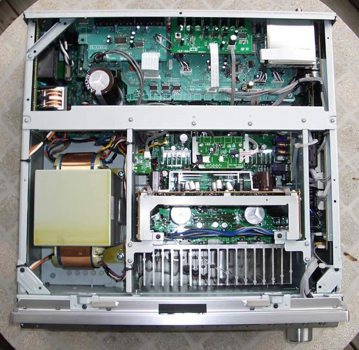

The only class D I have heard so far actually is the Sony and I was not impressed. I also talked to some sales people about the Panasonic and they did not have much good to say about it.
I am still trying to look into how Class D can get dynamic range with small capacitors and small transformers. To me it still seems like a cheap way of making an amp but thats why I am asking questions and doing some reading. And as far as subwoofers go they also operate in a very narrow frequency band compared to a full range amp. And I also believe that distortion is not as important in reproducing low frequency's that would explain the use of Class D the way I see it.
http://www.audioholics.com/productre...ES_inside1.jpg
Take a look at that amp inside the Sony STR-DA7100 and tell me that does not look like a cheap toy. They are calling it there S-Master Pro digital amplifier and for some reason a few years ago at CES. I could swear they said it was a class D amplifier but I could be wrong.

Class D refers to the power amplification stage, and it requires no transformers. Perhaps you're confusing the power supply with the power amp section?

it is a swps so you cannot compare its transformer size with that of a conventional power supply.
