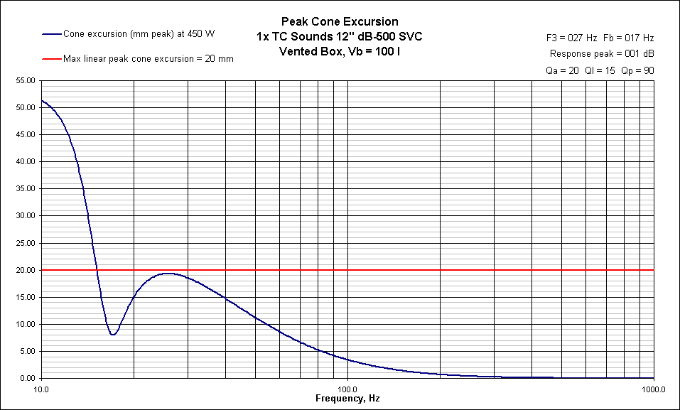

So I am now a little more familiar with WinISD. I plotted out 2 of the DB500s and WinISD gave me a suggested box of 201 liters at 21.77hz. 201 is unfortunately too big for what I want in my room.
So I changed it down to 125 liters at 21.77 and the response shows it down 1db at 30hz and down 3 db at about 24.5 hz. Is that not good?
If I left it at 201 liters, the graph shows it down 1 db around 22.5 and down 3 db at exactly 20 hz. While this is preferred, I just can't justify having a box that big in my family room.
If I have to, I could go up to 175 liters, but i'd prefer not to. 150 looks promising down 1 db around 27hz and down 3 db around 23hz.
Do these look okay? I'm sure it's not as good as what many here would like, but I would imagine better than many other subs available out there.
Am I looking at the right things?
thanks!

In playing around a bit with simulation, you really aren't gonna get too good of results with two drivers in a ported enclosure unless you are willing to go 200 liters at least. So with that said, I'd just go with a single more optimized one for now, and when the addiction kicks in down the road, you can go big time then.
I'm looking at 140 effective liters, 5" port that is 20.5" long, and a 500 watt plate amp with 18hz highpass filter. You might be able to find a 5" diameter piece on Sonotube at a hardware store - where 6" is typically the size, some have reported that you will find variations. Looks like 110db+ capability from 21hz up.
