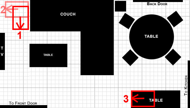

I had posted this when I bought the sub to determine best placement, but decided that location #1 was the best looking position and it sounded just fine. So that's where it is and it is likely going to stay
This picture is not 100% to scale, it is an estimate. The room size is ~ 14x35 (including the kitchen area, which is attached).

What is the distance from your ear to the TV wall when you sit in the main LP?
The marking at the bottom left labeled 'to front door' - how large is the space there? I assume the front door is not directly on that wall.
Your meter has only A weighting? No C weighting?

TV distance is 10'. Sub distance is 8.5'.
The area just outside the living room (labeled "to front door") is about 10'x10'x20' and connects the front door, a hallway into a room into the front of the house, a bathroom, and the stairway leading up along the top edge of the photo (right to left). This area is actually open to the second floor, which is why it's ~ 20' high.

Your current sub location should be great. What SPL meter is that? Even the Radio Shack meter has a C weighting! It is worthwhile investing in at least a Radio Shack meter, or get REW. With either one of those (REW preferred), you can get the bass set accurately.
