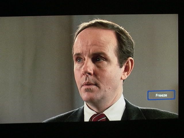

I finally caved in and bought an Epson 8100 projector! Looks unbelievable in the dark on 106" Grey Wolf screen. It's so so in ambient light so I just kept my 747 behind it.
The Epson gets washed out by ambient light in the day as you can see in the photo. Movie theater quality picture at night though. I didn't realize till after I got it that it has has a Reon VX Processor in it. I don't know how that compares to the HQV but it looks good.
I think the fish in my tank look a little nervous in the first picture.

So you guys are still here, eh, after all these years? My 747i is still working, thank god, but I do have issues. The screen burn-in. This is from me falling asleep watching tv on my playstation 3. I've since set the playstation to turn off automatically, but a really bad feature of this tv (at least imo) is that is shows the 'No Signal' in the left bottom corner and that's what is burned in. Also, watching a lot of 'square' (not widescreen) shows have also caused little lines.
Any way to fix/remove the burn-in for the tv? I've read that hooking up a pc and playing a screen saver of solid white over night might help, but haven't tried that. I also have unplugged the tv for a long time (a day?) and that seems to help too.
