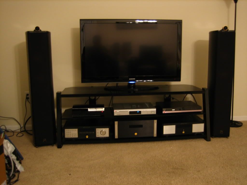

Thanks! and i will be using something from a company probably most people here have not heard of. I am using an amp and processor combo from Emotiva, an internet direct company that was originally under AV123. They are really big on this forum so some may know them.
I actually have two amps, the RPA-1 (2x300 @4ohms) and the XPA-3 (3x 350 @4ohms). The RPA-1 is a class H amp that has alot of finesse IMO, so i will probably be using that to power the Mozart Grands. The XPA-3 i will use for the Maestro when i get it, and the Haydns when i get them. Their products are built like tanks!!! my RPA-1 weighs 65lbs and the XPA-3 weighs 75lbs. And they sound GREAT. If you want specs on them just got to Emotiva.com. Oh and they are cheap since they are an ID company.
Here is a pic of my Processor, the DMC-1, which is on top and the RPA-1 which is on bottom.
And here is a pic of them all in my stand (almost to much weight lol!)

Yeah I see after the fact that your stands are angled forward a bit on the feet, at first I thought it was buckling under the load. Ive seen those somewhere before, I think it might have been when I was looking for a new pre-pro to replace my 3806/3808Ci. I've got a B&K Reference 200.5 S2, and really don't want to use the unbalanced interconnects. Thankfully B&K are finally about to release their 700 series Pre/Pro that supports HDMI switching along with all those fancy audio codecs, and best of all freaking balanced outputs
Anyway I'd love to be in your shoes - enjoying a Vienna Acoustics speaker for the first time. man.

lol yeah that picture does make it look like the stand is buckling under the weight! funny haha. And yeah the new Emotiva processor has alot of hype for its release.
My DMC-1 (processor) has balanced outs, and both my amps have balanced inputs. The B&K stuff is very very nice. My friend has a B&K amp, its very good. And dont worry, i'll be enjoying my Mozarts!
