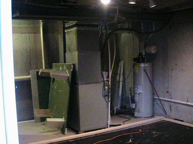

My last 2 years in the Fraternity House at Drexel in Philly, we built a deck in 2/3s of the room and we put my car sub box under the deck and it was known as the "The Thunder Deck".
The room in this house is unfinished under our kitchen and it measures 15'x15'x9' with no ducts whatsoever. Last fall I bought an Infocus 4805, WilsonArt laminate from HD, and black fabric from Joannes and overnight had a quasi "Movie Room" for movies and mostly the NFL season (Sunday Ticket HD games was the weekly hangout for our Fantasy Football league). The plan was to finish it for real after the Superbowl, so here we are.
I'm a noob in the Theater area (been reading here since the fall), but have been on AVS for years in the Plasma/HDTV forums, so ANY advice from you guys will be my greatest resource to help me build the best within my VERY tight budget. I'm very excited to start my own and post pictures for your amusement as I go.
I framed and built the deck (2x10s) this weekend with my little brother. The deck is resting on the 2x4 wall plates on the ends, and floating over the entire 15' span. I already did a sound test with the 12" Cerwin Vega and I can "feel" what it's gonna be like. I since bought a matching 10" Cerwin Vega figuring they'll complement each other well. So it's 1-12" and 1-10" mounted in the joist bays in perfect enclosures upfiring and ported up under an oversized coffee table.
Soon we're ready for electric, equipment rack in the rear, 12"x12" soffit on the back wall(for the projector) and sides for asthetics, routing wires, and I'm thinking 4" high hats. Not 100% on what I'm doing on the screen wall, or if I'm installing a soffit above the screen. I have 2 bump outs on the sides of the screen because of plumbing on the left side and the right side was to match. So any advice or comments are the reason I come to AVS....some days I feel like it's all I've done for 8 hours at work.

more photos to current.
That's my little bro cutting the 2x10s to size, and you can see the 2x6 step all along the front.
Probably doing 4 step lights, 2 on each step.

Few questions for you... When you say "no ducts what so ever", does that mean you'll be adding some in later? Your "Thunder Deck" looks pretty mean. Since you've tested the Vegas already, is the low frequencies a problem for you in the adjacent rooms?
post #7 of 116
No ducts meant it's a 9' ceiling in the basement, and it's all joists in this room. The drywall for the ceiling will screw directly to the joist bottoms (with a 12' soffit, with light bar in crown moulding)
The adjacent room is a 700 sqft jumbo playroom for the kids....toys, moon bounce, TV w/ video games, little kitchen, bball court, etc.
So subs rumbling is not an issue.
Having the quasi theater for the NFL season gave me a great preview of what life is like with a room like this, and it's either gametime and movietime.
For movietime, either everyone's watching or those that aren't are in bed. I don't want to be sound isolated from the upstairs, if someone's walking around the kitchen/FR I wanna hear them...cause they're not supposed to be there.
I do plan to GG the back wall where the water heater chimes on pretty damn loud during the SB !
