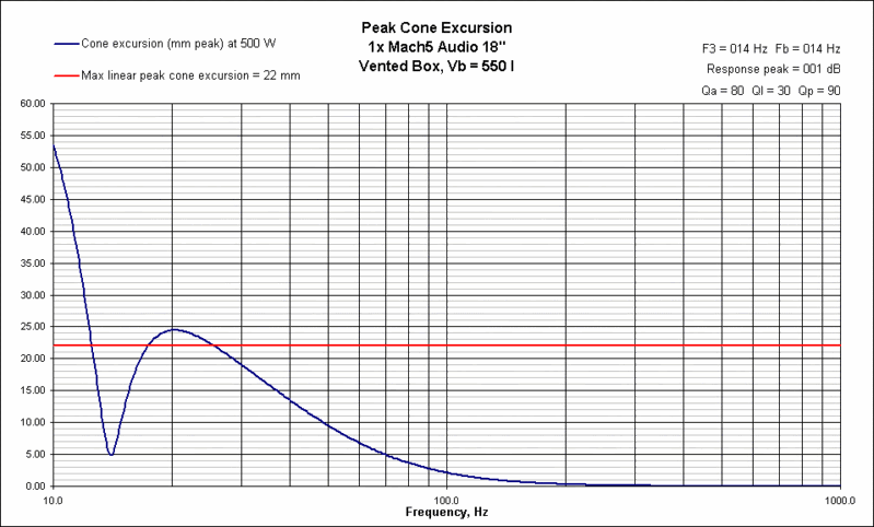

Just put my money down on the IXL-18.4. I think I'm planning on a 550l (~19.4cuft) enclosure tuned to 14Hz. With 350 Watts it puts out 112db at 12Hz without running a risk of overexcursion. I'm excited =D

What does the excursion look like with 550 L tuned to 14Hz with 500Watts?
post #18 of 30
I assume there's an 3-4mm Xmech. Don't know. Maybe Mark can answer this.

What do you think of 700l tuned to 13hz with 250 watts? I was just on my roommates computer modeling some of it and that doesn't look to bad. Your thoughts?
