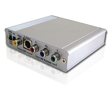

It sure looks nicer than the Apple TV device. I like the brushed aluminum case. What's the price? If you get it please post back your impressions.
post #40 of 676
$209 plus shipping.
It's made by Ambery.
http://www.ambery.com/covitocovisc.html
For some reason, I'm going towards the Ambery if only because there is a component pass-through that will remove macrovision. I don't know why I'd ever need it but I just feel like I might one day.

It's more expensive than the Apple device but it seems to do much more. AFAIK the other component to S-video adapter Nextoo talked about, it will only convert 480i component to 480i S-video. The device you linked looks like it will take 480i-1080p and both downconvert to 480i for S-video/composite and pass thru the native resolution. That sounds really nice and would sure work with something like the DTVPal DVR which does not output 480i via component, so the other converter wouldn't work while this one would.
If you don't mind I'm going to put your link in the other thread since the title of this thread is "cheaper" component to S-video converter. Yours isn't cheaper but sure sounds more flexible. Lastly, are you sure the Ambery device removes CP? Maybe I missed it but I didn't see it mentioned in your link.
It appears to be much better than the apple svideo converter for the reason you mention. It down converts a high definition source to 480i output. Plus it seems to offer high definition passthrough via component output simultaneously.
The apple svideo converter requires a 480i feed (it does not down convert) and some cableco boxes are now not providing a full widescreen image if the box is set to 480i - even via component output. So in these cases the apple svideo converter becomes useless.
As far as CP is concerned it seems that when a component input is converted to svideo the CP gets left behind. So pretty much any device that does this type of conversion eliminates any CP concern (edit - cableco/satco CP concern). This is probably the number one reason why DVD recorders with component inputs disappeared from the market as quickly as they did.

I just thought I would report that I bought the Ambery device listed here and it works great. Thanks digital freak for posting it.
I wish it didn't cost twice as much as the dvd recorder I'm using it with, but it does everything that it advertises so I'm happy. I can now record programs off my dvr in native widescreen format which is great.

Thanks for reporting back. So, to be clear does it indeed convert component HD down to anamorphic 480i via s-video?
Also, do you know if it preserves (or adds) a widescreen flag, and finally does it also strip copy protection?
Sorry about all the questions...I sent Ambery an email and they never responded.
post #49 of 676
Yes, it converts component HD video down to anamorphic 480i via s-video. This was the reason I purchased it.
When recording, it did not set the widescreen flag. I don't know if this is because of the Ambery device or if certain stations aren't accurate about setting it properly. Do all HD channels set this flag as Y? I have a Toshiba DR420 which can set this flag for me. When I left it to automatic, it did not work properly so I had to force it on the dvd recorder to turn the flag to set to widescreen. I actually purchased the Toshiba over the Panasonic because of this feature since this was the only company I could find that offered this.
I just got the device and havn't recorded too much, but it was ok recording Dollhouse from FOX and I think it was CNN HD or maybe it was another HD news channel. I'll do a couple tests tonight to see if there are any copy protection issues.

I played with it a bit tonight but couldn't find anything at all that has copy protection from my DVR. I know there is copy protection when using firewire, but I tried a number of stations just using composite without using the Ambery box and all seemed to record ok so I don't have a benchmark to test with.
I have Verizon FIOS with digital cable, but no extra pay channels (HBO, Showtime, etc) so I wasn't able to try them.
I tried passing the output of a dvd player into the dvd recorder and it would not let me record that so I thought maybe I could try using that with the Ambery device. But I got no picture at all when passing through the Ambery device. I guess it has to be a high def signal for that to work.
I'm not sure what else I can try.

The only thing I can think of to test in your case would be: If your DVDR has a HDD and component out, you could connect the component out into the Ambery unit, and connect from the Ambery via composite or s-video to an input on the same DVDR. Then play a copy protected DVD and try to record to the HDD. That would confirm, but I don't know if you have the necessary cables, and you've already done more than enough.
