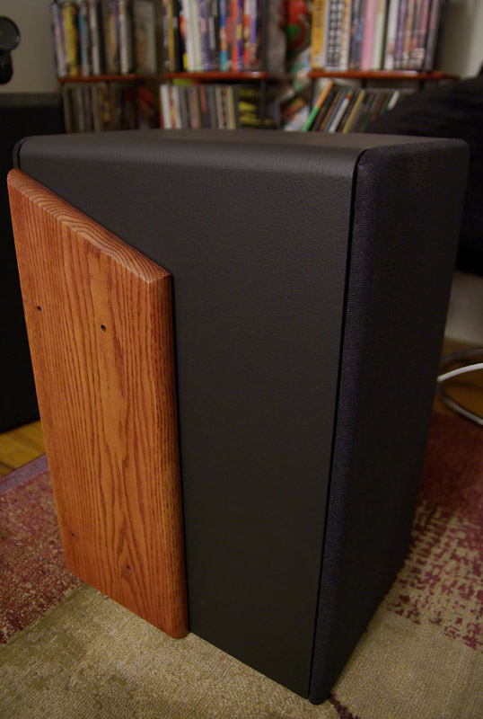

Ok, finally have 5 posts so here goes.
the baby sub...
the project i modified for it.
http://www.partsexpress.com/projects...aSub/index.cfm
Basic dimensions are 20 high by 10 wide, by 13 deep. The front and back face are 3/4" MDF glued to 1/2" baltic birch in such a manner that the MDF is on the outside and the birch is between that and the MDF sides. Two 8.5" by 3" braces internally. Egg crate foam on the sides, top, and bottom. Red oak for the decorative panels with 1/16" black craft felt sandwiched in between. black finish is chalk baord paint applied with a roller over a sealed and primed base.
Front has the one active woofer, and there is one passive radiator up top front and back. 70W plate amp in the back on the bottom.
speaker grills have been redone with 1/4" staples rather than spray adhesive and look like factory finished parts when on now.
The sound out of this sucker is pretty surprising for an 8" sub.
post #12 of 15
raz-0,
Looking great your sub! The wood panels add a nice touch. Good work
