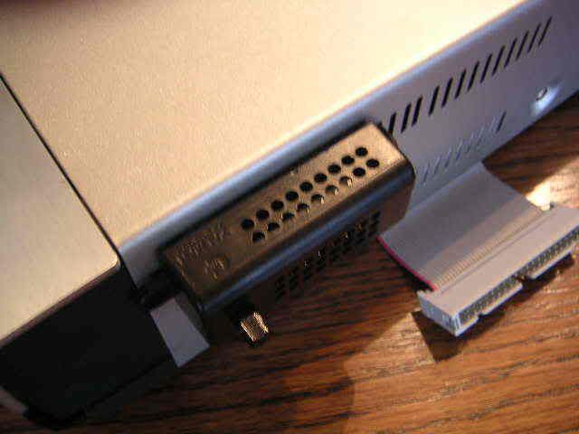

scorpio3 - sorry I missed your post on the drive setting. Yes you do need some sort of gender changer in order to have a break off point when connecting the external drive especially when using an external enclosure. I wound up making my own m/m cable as a junction point and it works fine.
The custom cable route is a bit pricey. I also found these:
http://cablesonline.stores.yahoo.net/40pinmaidc2p.html
Cheap and I am sure they will work fine.

scorpio3 - here's an example of the M/M IDE cable I made up. The ATAPI adapter is plugged into the cable inside the case and the other end on the outside that is shown makes a nice breakout point. This is on an XS54. The black piece you see attached to the side is a fan regulator. It allows you to adjust the speed of the fan.
[IMG]Photo Sharing and Video Hosting at Photobucket[/IMG]
