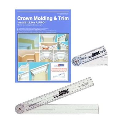

Instead of hijacking Curtis's build thread with crown molding tips, let me cross post what I post there in your thread...
Get yourself a good "how to do trim molding" book. It will make the job a lot easier to do. One that I personally recommend is this book.
BTW - when you cut trim (and yes your 10" sliding saw will work just fine) you don't actually want it to lay flat. It should lay on the saw as it would sit upside down on the wall (at an angle between the bottom and back plates of the saw).
Coping can be learned, but it isn't easy. I have done all of my crown molding as miter cuts, but because I paint the molding and use not decorative stock, I can fill in gaps with caulk. You won't get good results if you don't cope the decorative stuff. I did promise myself that next molding project I try coping again. Even got myself a new tool that should help.
(posted here as well as CurtisG's thread, trying to end my thread hijack)
Already got that book a couple of months back. Thanks for reminding me, I just pulled it out and scanned it.
By the way, looking through that book, they show your 'at an angle between the back and bottom plate' method for a regular miter saw that doesn't tilt left and right (page 27). For a compound miter saw, they show the crown molding lying flat on the table. You turn the table left/right and tilt the saw left/right to get the compound cuts.
I'll need to take a weekend to goof around with scraps and see how it goes.

Try this. No compound angles required.
http://cutncrown.com/?cid=google&gcl...FSQtagodXV-ilQ
Cool. It looks like the same angle finder that came with my book, along with a jig cut at the correct angle to hold the crown molding for a non-compound miter saw. Simpler and more secure than leaning it up against the back fence.
To start with, I'll try the compound angles. I'm not that worried about that part.
I'll also experiment with miters vs. coping. I must admit I'm convinced that I can make 'perfect' looking miters, even on the ornate molding, but since so many people do coping (there must be a reason, right?) I won't really be sure until I get it to work.
